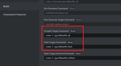

Hello @unsigned_char_array ,
To build and compile from within Designer you have to use a Makefile.
Here is an example from a project I am working on :
A good starting point for you could be to create a new project by selecting a discovery or evaluation board with the same MCU that you are using (if there is one) and look for the Makefile in the GCC folder to get inspired (copying it completely could work but I am not sure).
If this answer you issue, I invite you to select this comment as "best answer".
