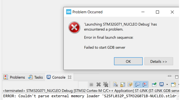

Im trying to start ith TouchGFX with the X-Nucleo-GFX01M1.
with CubeProgrammer I have the error : failed to download Segment[1].
Using TouchGFX 4.18.1 Designer is possible to download the GUI. So, there is not problem of comunciation with the PC.
Using STM32Cube come the error Failed to start GDB server. I have read on internet that this error is connected to window dll bla bla bla. ok. fine. I have reinstalled all Window10. No solution and the same error.
Using CubeProgrammer and load the file example provide from ST: GFX01M1_HelloWorld.hex I have the error failed to download Segment[1].

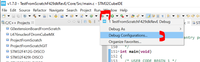

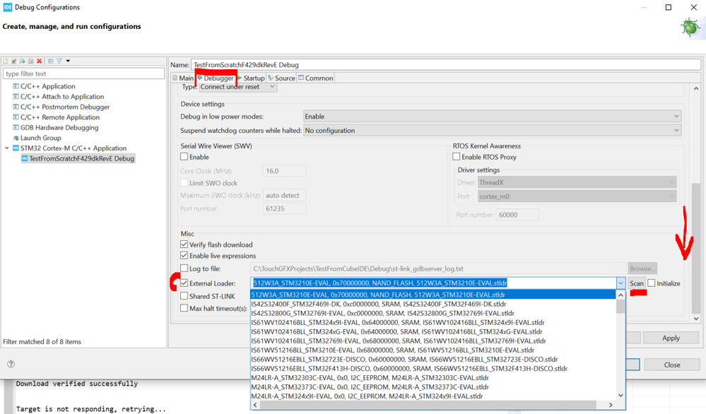

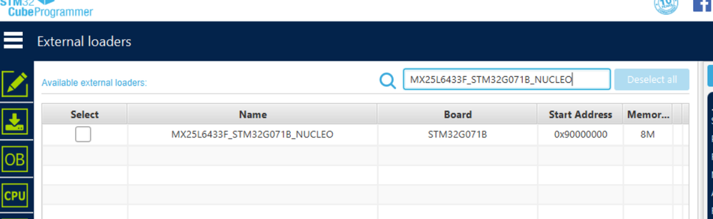

Are you using the external flash ?
If so, do you select the proper external loader in the STM32CubeProgrammer "EL" panel ?
If you do not find it in the STM32CubeProgrammer external loader list you need to :
Note that STM32CubeIDE has its own embedded CubeProgrammer so the .stldr file must be copied to :
C:\ST\STM32CubeIDE_1.8.0\STM32CubeIDE\plugins\com.st.stm32cube.ide.mcu.externaltools.cubeprogrammer.win32_2.0.100.202110141430\tools\bin\ExternalLoader
I hope this will help,
Best regards,
Nicolas

2022-01-21 12:38 AM

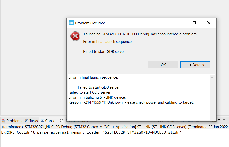

You can see in the error message at the bottom of your last picture that the external loader used is the S25FL032P and not the MX25L6433F. So you have properly added the MX25L6433F to your repository but you have not actually set your project to use it. To do so, click on either the arrow next to the debug or run options and go to the "Debug Configurations" or "Run Configurations" menus (in the following picture I go to the debug one).Within that new view, go to the Debugger tab, scroll down to the bottom and check the external loader used. If nothing is shown press the scan option and go through the list to select the correct version.
/Romain

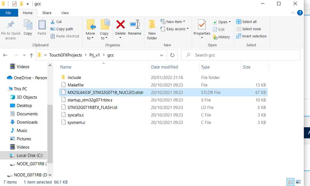

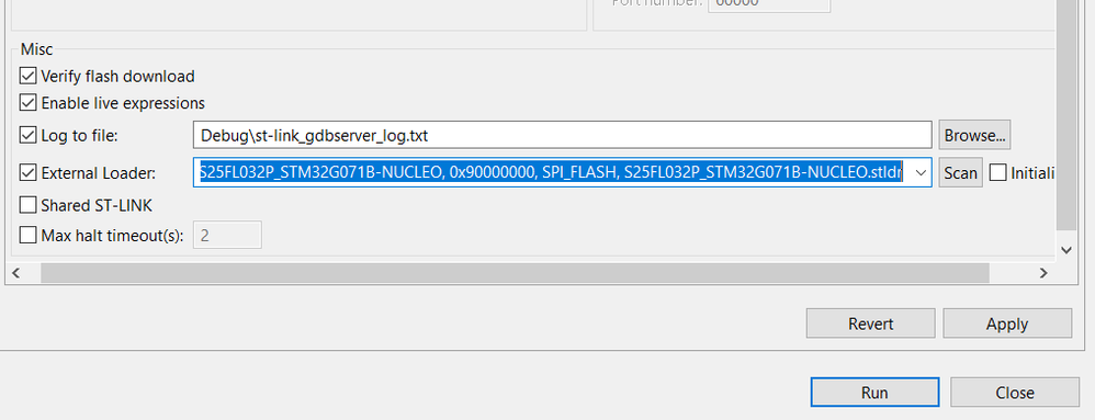

2022-01-22 1:34 AM
I have followed your instruction and the S25FL032P_STM32G071B-NUCLEO.stldr was already selected.I did anyway a scan again-
When I compile it , I have the same error.
in the prject folder there is MX25L6433F_STM32G071B_NUCLEO.stldr. Should I change it manually with S25FL032P_STM32G071B-NUCLEO.stldr ?
And where could I find this file?
For my curiosity I have selected MX25L6433F to see what could happen given that in my project folder i have only that....and something strange happened:

2022-01-24 3:01 AM
You misunderstood my message. You should use the MX25L6433F_STM32G071B_NUCLEO.stldr and not S25FL032P_STM32G071B-NUCLEO.stldr which was the one set in your project.
I'm a bit confused about the "switching context" messages but it might be something expected.
/Romain
