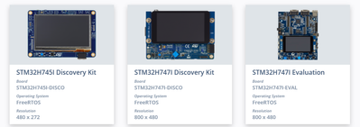

  • Yes you can find examples of it in the TouchGFX Designer. These 3 TBS are using dual cores :
