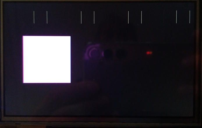

1. The NemaGFX for this platform only seems to work with 32-bit framebuffers, not 24-bit ones. Or am I doing something wrong?
2. The NemaGFX for this platform uses the beginning of the framebuffer as a sort of workspace. We see random dots at the beginning. I think I'm having trouble allocating buffers correctly.

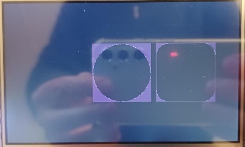

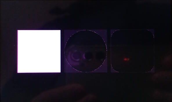

3. I can draw filled rectangles, but filled circles with 'nema_vg_draw_circle()' only show the edge slightly and produce small images in a sort of workspace at the beginning of the frame buffer.
nema_vg_set_fill_rule(NEMA_VG_FILL_NON_ZERO); does not fill the shape, as it should.
Well, 'nema_vg_draw_rect()' works fine with nema_vg_set_fill_rule(NEMA_VG_FILL_NON_ZERO).
4. Many more graphics functions don't work properly on the STM32H7S78, but they all work fine on the STM32U5G9J, which one uses 24-bit framebuffers, while the STM32H7S78 can only work with 32-bit framebuffers, it seems. This could be a reason.
nema_vg_set_fill_rule(NEMA_VG_FILL_EVEN_ODD); It does fill the circle, but there still are the four small images in the frame buffer displayed in white.
What am I doing wrong?
So I use the next framebuffer, and I don't have the random pixels at the top, but it doesn't solve drawing a filled circle, rounded filled rectangle, and a lot of other functions don't work properly.
Note the filled rectangle with no rounded corners works, but a rounded filled rectangle only shows the corners somewhat, it has the same problem as the filled circle:

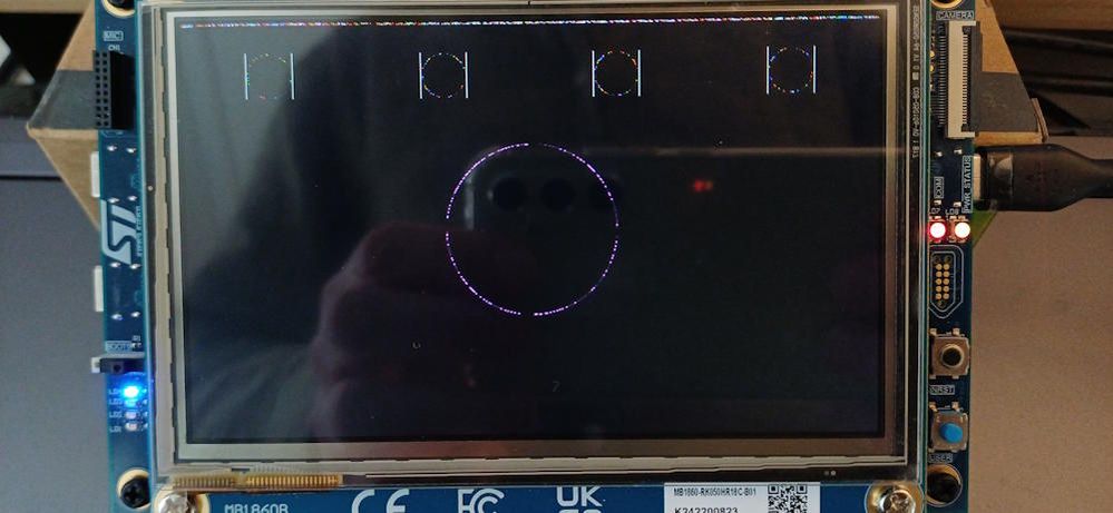

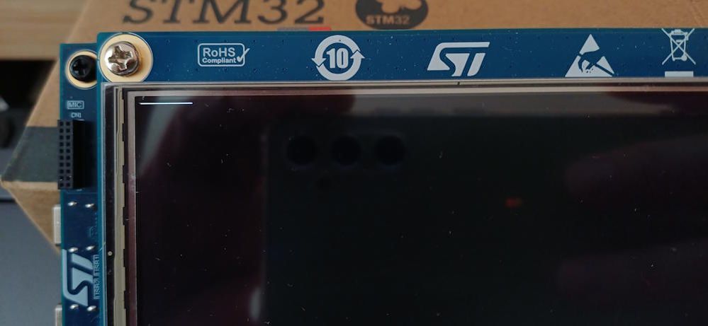

When I run nema_stencil_init(), a row of white dots appears at the beginning of the framebuffer.
This happens if this function calls one of these:
- nema_vg_init()
- nema_vg_init_stencil_pool(DISPLAY_SIZE_W, DISPLAY_SIZE_H, 1);
- nema_vg_init_stencil_prealloc(fbo.w, fbo.h, stencil_bo);
So something is definitely wrong. Even when nema_vg_init() is executed, this seems to happen, regardless of where my framebuffer is located.

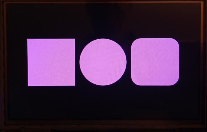

Let's try to take a step back and start from one of the NeoChromSDK examples (I tested with version 1.3.0):
start with this:
\NeoChromSDK\Projects\STM32H7S78-DK\Applications\GPU2D\vector_watchface\
Find the file
\NeoChromSDK\Projects\STM32H7S78-DK\Applications\GPU2D\vector_watchface\Src\svg.c
Replace the app_main() function in that file with this:
void app_main()
  nema_vg_init_stencil_pool(RESX, RESY, STENCIL_MEM_POOL_ID);
  nema_cmdlist_t cl = nema_cl_create_sized(8 * 1024);
  nema_cl_bind_sectored_circular(&cl,8);
  unsigned char green_channel = 0x00;
  while(run)
    img_obj_t *fbo = get_current_framebuffer();
    nema_bind_dst_tex((uintptr_t)fbo->bo.base_phys, fbo->w, fbo->h, fbo->format, fbo->stride);
    nema_set_clip(0, 0, RESX, RESY);
    nema_clear(nema_rgba(0xff, green_channel++, 0, 0xff));
    nema_matrix3x3_t m;
    NEMA_VG_PAINT_HANDLE paint;
    paint = nema_vg_paint_create();
    nema_mat3x3_load_identity(m);
  //  nema_mat3x3_translate(m, 0.0, 0.0); // fun to play with
  //  nema_mat3x3_rotate(m, 0.0); // fun to play with
  //  nema_mat3x3_scale(m, 1.0, 1.0); // fun to play with
    nema_vg_paint_set_type(paint, NEMA_VG_PAINT_COLOR);
    nema_vg_paint_set_opacity(paint, 1.0);
    nema_vg_paint_set_paint_color(paint, nema_rgba(0xFF, green_channel, 0xFF, 0xFF));
    nema_vg_stroke_set_width(15.0);
    // Choose a fill rule
    nema_vg_set_fill_rule(NEMA_VG_STROKE);
//    nema_vg_set_fill_rule(NEMA_VG_FILL_EVEN_ODD);
//    nema_vg_set_fill_rule(NEMA_VG_FILL_NON_ZERO);
    // Basic blend mode setup for now
    nema_set_blend_fill(NEMA_BL_SRC_OVER);
    nema_vg_set_blend(NEMA_BL_SRC_OVER);
    nema_enable_aa_flags(1);
    nema_vg_set_quality(NEMA_VG_QUALITY_MAXIMUM);
    nema_vg_draw_rect(80, 140, 200, 200, m, paint);
    nema_vg_draw_circle(400, 240, 100, m, paint);
    nema_vg_draw_rounded_rect(520, 140, 200, 200, 40, 40, m, paint);
    nema_cl_submit(&cl);
    nema_cl_wait(&cl);
    swap_buffers(); // wait for sync up with the LTDC controller
    nema_vg_paint_destroy(paint);
  nema_cl_unbind();
  nema_cl_destroy(&cl);
This example draws your three vg shapes. All the exotic blending operations from previous is reduced to simple NEMA_BL_SRC_OVER. The rending is in sync with the LTDC by calling swap_buffers(). In this configuration you can play with nema_vg_set_quality() and nema_vg_set_fill_rule(). This configuration draws every time on my board.
Can you reproduce this setup?

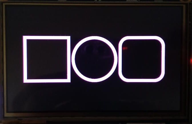

So we I can render some things (rectangles with sharp corners, for example), but a lot of things aren't working yet, like filled circles or filled rounded rectangles.
With stroked versions of these, they work surprisingly well, like before. I just wanted to note this again.

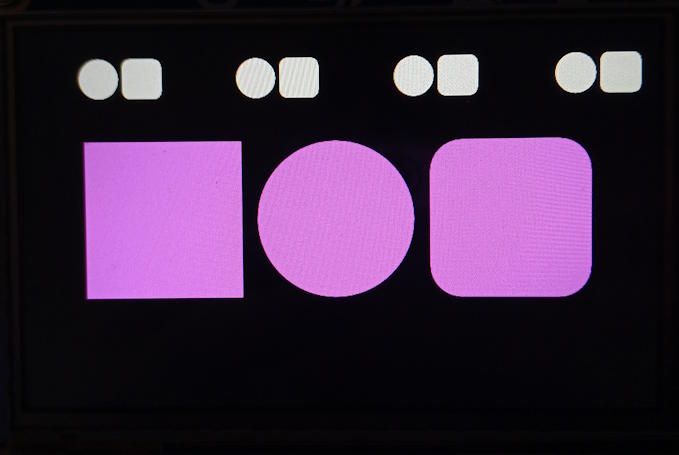

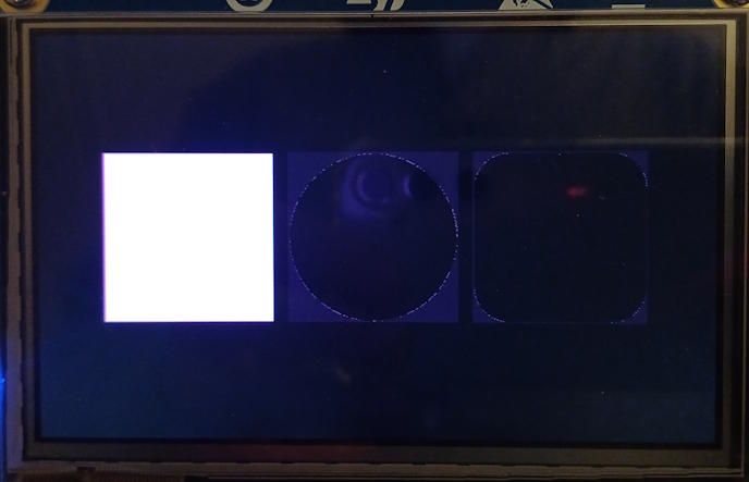

Note: Ghost images at the top: NemaGFX uses workspace inside the framebuffer!
The shown ghost images only reflect the rendering of the two right primitives.

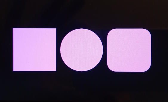

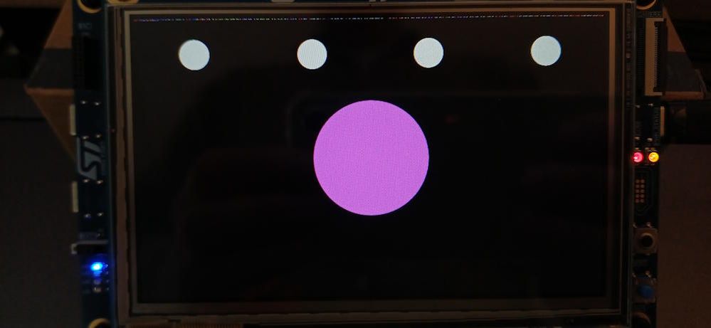

Remember, the in the above picture shown shown ghost images reflected the two right primitive.
They no longer appear in the image below, using NEMA_VG_FILL_NON_ZERO.
After this, I start drawing lots of random colored stroked rectangles at random positions 80x80, stroke 10.
STM32H7S7L8 600MHz 32BPP: 7120 rectangles/sec.

Hi Jakob, thank you!
I addressed above issues. Though, the rendering problems with the shapes remain the same.
Ruled out:
- The framebuffer depth.
- The version of NemaGFX.
- The initialization of NemaGFX.
What changed:
1) Corrected set up of memory pools for the nemagfx library.
2) Configured cache management when drawing vector graphics.
3) Tested 24-bit framebuffers using GFXMMU (shows no difference).
Note:
- NEMAGFX_STENCIL_POOL_SIZE = 389120, which is 800*480 +5120.
Using 384000 does not work. Why are the extra 5120 bytes required to let the GPU work?
In this example, the last two functions are not renedering correctly. However, there are more functions that expose renderings issues.
nema_vg_draw_rect(80, 140, 200, 200, NemaGFX.m, NemaGFX.paint); /* Works */
nema_vg_draw_circle(400, 240, 100, NemaGFX.m, NemaGFX.paint); /* Fails*/
nema_vg_draw_rounded_rect(520, 140, 200, 200, 40, 40, NemaGFX.m, NemaGFX.paint); /* Fails*/
The difference between the STM32H7S7 and the STM32U5G9:
The STM32H7S7 (Cotex-M7) reveals rendering issues in the 2nd and 3rd shape:
The STM32U5G9 (Cotex-M33) works flawless:
Due to the failing GPU2D/NemaGFX on the STM32H7RS (Cotex-M7) and the STM32N6 (Cotex-M55), we will instead use the STM32U5G9J (Cotex-M33) which works flawless after successful tests.
And for those interested, there's the revised nema_hal.c, linker file, and ioc file.
Feedback is always welcome!
If I find a solution for the STM32H7RS, I'll be sure to post an update on the cause of the problem.
It may be my mistake, though I have no issues with the STM32U5G9J.
I noticed the versions below:
STM32U5x9 v3.5.0 - Works fine
STM32H7RS v1.3.0 - Reveals rendering issues with the vg libraries
STM32N6 v1.3.0 - Reveals rendering issues with the vg libraries
So I assume the NemaGFX v1.3.0 versions for the m7 and m55 aren't finished yet, regarding the vg libraries.
I also noticed the STM32N6 has a bug when using the NEMA_BGR565 format, while NEMA_RGB565 works fine.

Hi Jakob!
Thank you very much for responding.
We always need to set:
Otherwise, a 45 degree rotated square is cut from the interior of a filled circle.
So even though I set it as the default, it didn't solve the problem.
Below is my code snippet for testing:
  Display.NemaGFX.cl = nema_cl_create_sized(8192);
  nema_cl_bind_circular(&Display.NemaGFX.cl);
  nema_bind_dst_tex(Display.NemaGFX.fbo.bo.base_phys, Display.NemaGFX.fbo.w, Display.NemaGFX.fbo.h, Display.NemaGFX.fbo.format, Display.NemaGFX.fbo.stride);
  nema_bind_src_tex(Display.NemaGFX.fbo.bo.base_phys, Display.NemaGFX.fbo.w, Display.NemaGFX.fbo.h, Display.NemaGFX.fbo.format, Display.NemaGFX.fbo.stride, NEMA_FILTER_PS);
  nema_set_clip(0, 0, DISPLAY_SIZE_W, DISPLAY_SIZE_H);
  nema_blending_mode(NEMA_BF_SRCALPHA, NEMA_BF_INVSRCALPHA, NEMA_BLOP_MODULATE_A);
  Display.NemaGFX.paint = nema_vg_paint_create();
  nema_vg_paint_clear(Display.NemaGFX.paint);
  nema_mat3x3_load_identity(Display.NemaGFX.m);
  nema_mat3x3_translate(Display.NemaGFX.m, 0.0, 0.0);
  nema_mat3x3_rotate(Display.NemaGFX.m, 0.0);
  nema_mat3x3_scale(Display.NemaGFX.m, 1.0, 1.0);
  nema_vg_paint_set_type(Display.NemaGFX.paint, NEMA_VG_PAINT_COLOR);
  nema_vg_paint_set_opacity(Display.NemaGFX.paint, 1.0);
  nema_vg_paint_set_paint_color(Display.NemaGFX.paint, nema_rgba(0xFF, 0x00, 0xFF, 0xFF));
  nema_vg_set_blend(NEMA_BL_SRC_OVER| NEMA_BLOP_SRC_PREMULT | NEMA_BLOP_SRC_CKEY);
  nema_enable_aa(1, 1, 1, 1);
   * This quality setting is required to get nice rounded corners and avoid
   * displaying a cut-out 45 degrees rotated square inside a filled circle!
  nema_vg_draw_rect(80, 140, 200, 200, Display.NemaGFX.m, Display.NemaGFX.paint);
  nema_vg_draw_circle(400, 240, 100, Display.NemaGFX.m, Display.NemaGFX.paint);
  nema_vg_draw_rounded_rect(520, 140, 200, 200, 40, 40, Display.NemaGFX.m, Display.NemaGFX.paint);
  nema_cl_unbind();
  nema_cl_submit(&Display.NemaGFX.cl);
  nema_cl_wait(&Display.NemaGFX.cl);
  nema_cl_destroy(&Display.NemaGFX.cl);
  nema_vg_paint_destroy(Display.NemaGFX.paint);
Am I perhaps missing something else?
Kind regards, Jack.

Hi Jakob,
thank you veru much!
I modified the HAL_GPU2D_ErrorCallback function so it will hang in a loop.
The result is dat no hang occurs (after this test, rectangles with random color and position are printed endlessly).
I noticed that commenting out this line causes the rectangle on the left to no longer display:
// nema_vg_set_blend(NEMA_BL_SRC_OVER| NEMA_BLOP_SRC_PREMULT | NEMA_BLOP_SRC_CKEY); // not needed / does nothing when drawing filled shapes
The other two shapes look the same:
I tried the NemaGFX SDK v1.3.0 and the one provided by TouchGFX studio, and I'm using
libnemagfx-float-abi-hard.a
So, something else must be wrong, I guess.

Hi @Jack3
start with this:
Find the file
void app_main()
  while(run)
    nema_matrix3x3_t m;
    nema_cl_wait(&cl);
  nema_cl_unbind();
