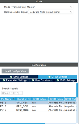

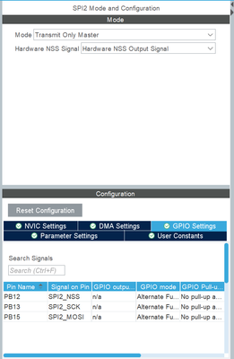

This is SPI configuration.

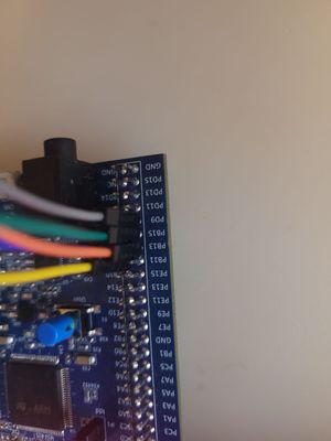

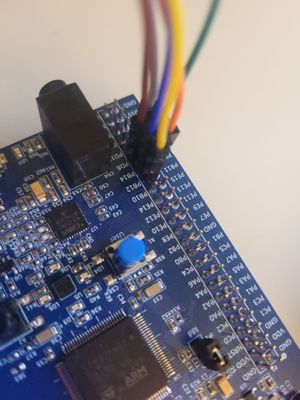

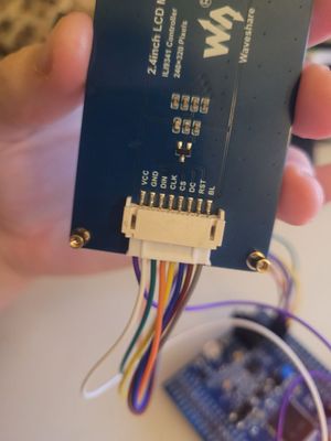

I have checked the physical wiring, and it seems to be correct.

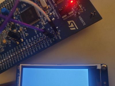

2026-01-26 2:07 AM
I have resolved the problem! The biggest issue was that I based my LCD Reset code on the official driver, which does not assume SPI. So, I used some commands that made sense for parallel protocols but not SPI. I rewrote my Reset function based on this driver (https://github.com/martnak/STM32-ILI9341/blob/master/Src/ILI9341/ILI9341_STM32_Driver.c). I have also switched to software NSS, but I am not sure if this was one of the causes.

@cockatoo wrote:I have checked the physical wiring, and it seems to be correct.
Please post the schematic so that others can check & confirm.
Also a good, clear photo can help.
Have you checked carefully that the connections you use are not "obstructed" by other features on the board?

uint8_t params_LCD_POWER2[1] = { 0x10 };
HAL_SPI_Transmit(&hspi2, params_LCD_POWER2, 1, 100);
HAL_GPIO_WritePin(DC_GPIO_PORT, DC_GPIO_PIN, GPIO_PIN_RESET);
uint8_t cmd_LCD_VCOM1[1] = { LCD_VCOM1 };
HAL_SPI_Transmit(&hspi2, cmd_LCD_VCOM1, 1, 100);
HAL_GPIO_WritePin(DC_GPIO_PORT, DC_GPIO_PIN, GPIO_PIN_SET);
uint8_t params_LCD_VCOM1[2] = { 0x45, 0x15 };
HAL_SPI_Transmit(&hspi2, params_LCD_VCOM1, 2, 100);
uint8_t cmd_LCD_VCOM2[1] = { LCD_VCOM2 };
HAL_SPI_Transmit(&hspi2, cmd_LCD_VCOM2, 1, 100);
uint8_t params_LCD_VCOM2[1] = { 0x90 };
HAL_SPI_Transmit(&hspi2, params_LCD_VCOM2, 1, 100);
uint8_t cmd_LCD_MAC[1] = { LCD_MAC }; //MAYBE CHANGE PARAMETER
HAL_SPI_Transmit(&hspi2, cmd_LCD_MAC, 1, 100);
uint8_t params_LCD_MAC[1] = { 0xC8 };
HAL_SPI_Transmit(&hspi2, params_LCD_MAC, 1, 100);
uint8_t cmd_LCD_3GAMMA_EN[1] = { LCD_3GAMMA_EN };
HAL_SPI_Transmit(&hspi2, cmd_LCD_3GAMMA_EN, 1, 100);
uint8_t params_LCD_3GAMMA_EN[1] = { 0x00 };
HAL_SPI_Transmit(&hspi2, params_LCD_3GAMMA_EN, 1, 100);
uint8_t cmd_LCD_RGB_INTERFACE[1] = { LCD_RGB_INTERFACE };
HAL_SPI_Transmit(&hspi2, cmd_LCD_RGB_INTERFACE, 1, 100);
uint8_t params_LCD_RGB_INTERFACE[1] = { 0xC2 };
HAL_SPI_Transmit(&hspi2, params_LCD_RGB_INTERFACE, 1, 100);
uint8_t cmd_LCD_DFC2[1] = { LCD_DFC };
HAL_SPI_Transmit(&hspi2, cmd_LCD_DFC2, 1, 100);
uint8_t params_LCD_DFC2[4] = { 0x0A, 0xA7, 0x27, 0x04 };
HAL_SPI_Transmit(&hspi2, params_LCD_DFC2, 4, 100);
/*HAL_GPIO_WritePin(DC_GPIO_PORT, DC_GPIO_PIN, GPIO_PIN_RESET);
uint8_t cmd_LCD_COLUMN_ADDR[1] = { LCD_COLUMN_ADDR };
HAL_SPI_Transmit(&hspi2, cmd_LCD_COLUMN_ADDR, 1, 100);
uint8_t params_LCD_COLUMN_ADDR[4] = { 0x00, 0x00, 0x00, 0xEF };
HAL_SPI_Transmit(&hspi2, params_LCD_COLUMN_ADDR, 4, 100);*/
uint8_t cmd_LCD_PAGE_ADDR[1] = { LCD_PAGE_ADDR };
HAL_SPI_Transmit(&hspi2, cmd_LCD_PAGE_ADDR, 1, 100);
uint8_t params_LCD_PAGE_ADDR[4] = { 0x00, 0x00, 0x01, 0x3F };
HAL_SPI_Transmit(&hspi2, params_LCD_PAGE_ADDR, 4, 100);*/
uint8_t cmd_LCD_INTERFACE[1] = { LCD_INTERFACE };
HAL_SPI_Transmit(&hspi2, cmd_LCD_INTERFACE, 1, 100);
uint8_t params_LCD_INTERFACE[3] = { 0x01, 0x00, 0x06 };
HAL_SPI_Transmit(&hspi2, params_LCD_INTERFACE, 3, 100);
uint8_t cmd_LCD_GRAM[1] = { LCD_GRAM };
HAL_SPI_Transmit(&hspi2, cmd_LCD_GRAM, 1, 100);
HAL_Delay(200); // wait 200 ms before sending pixel data
uint8_t cmd_LCD_GAMMA[1] = { LCD_GAMMA };
HAL_SPI_Transmit(&hspi2, cmd_LCD_GAMMA, 1, 100);
uint8_t params_LCD_GAMMA[1] = { 0x01 };
HAL_SPI_Transmit(&hspi2, params_LCD_GAMMA, 1, 100);
uint8_t cmd_LCD_PGAMMA[1] = { LCD_PGAMMA };
HAL_SPI_Transmit(&hspi2, cmd_LCD_PGAMMA, 1, 100);
uint8_t params_LCD_PGAMMA[15] = {
0x0F, 0x29, 0x24, 0x0C, 0x0E,
0x09, 0x4E, 0x78, 0x3C, 0x09,
0x13, 0x05, 0x17, 0x11, 0x00
HAL_SPI_Transmit(&hspi2, params_LCD_PGAMMA, 15, 100);
uint8_t cmd_LCD_NGAMMA[1] = { LCD_NGAMMA };
HAL_SPI_Transmit(&hspi2, cmd_LCD_NGAMMA, 1, 100);
uint8_t params_LCD_NGAMMA[15] = {
0x00, 0x16, 0x1B, 0x04, 0x11,
0x07, 0x31, 0x33, 0x42, 0x05,
0x0C, 0x0A, 0x28, 0x2F, 0x0F
HAL_SPI_Transmit(&hspi2, params_LCD_NGAMMA, 15, 100);
// Sleep Out
uint8_t cmd_LCD_SLEEP_OUT[1] = { LCD_SLEEP_OUT };
HAL_SPI_Transmit(&hspi2, cmd_LCD_SLEEP_OUT, 1, 100);
HAL_Delay(200); // wait 200 ms for the LCD to wake up
// Display On
uint8_t cmd_LCD_DISPLAY_ON[1] = { LCD_DISPLAY_ON };
HAL_SPI_Transmit(&hspi2, cmd_LCD_DISPLAY_ON, 1, 100);
}The driver is https://github.com/STMicroelectronics/stm32-ili9341/blob/main/ili9341.c.
Basic SPI communication does work, because the following snippet visibly resets the screen.
//reset the screen
HAL_GPIO_WritePin(RST_GPIO_PORT, RST_GPIO_PIN, GPIO_PIN_RESET); // pull low
HAL_Delay(10);
HAL_GPIO_WritePin(RST_GPIO_PORT, RST_GPIO_PIN, GPIO_PIN_SET); // release reset
HAL_Delay(120);
2025-12-02 2:49 AM
@cockatoo wrote:Basic SPI communication does work, because the following snippet visibly resets the screen.
But that snippet does not use SPI at all !
It's purely asserting the hardware reset line.
So that tells you absolutely nothing about the operation of the SPI !
2025-12-02 2:57 AM
I have commented out the main() code for non-screen functionality, however, it still does not work.
2025-12-02 3:01 AM - edited 2025-12-02 3:05 AM
Have you verified the basic SPI operation yet ?
Without basic SPI comms, nothing is ever going to work.
PS:
Edited as you have a write-only SPI, so can't read anything
2025-12-02 3:32 AM
How do I check if it works?
