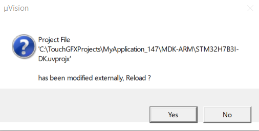

But why is it not enough to exclude the files from the Keil project? I would expect: when neither the files of a screen (view+presenter) are included in the uvprojx nor the screen is existent in the TouchGFX Designer, than the files should be ignored by the code generator of TouchGFX Designer. But they are not. A screen deleted in Designer and excluded from Keil pops up in Keil everytime I generate the code from the designer. Is that also on purpose?

I've just made the test on my side, and deleted screens files are not included in my Keil project. So I can't reproduce your issue. Which version of Keil are you using ? I'm working with uVision V5.32.0.0, and it works perfectly fine here. Do you have this kind of popup on Keil whenever you regenerate code on TouchGFX Designer ?

The pop up shows up most of the times, sometimes not. But the new code is there even without the pop up.

I tried the steps you wrote, I don't have the same behavior. When I delete the screen4 in designer, the screen4View.cpp and screen4Presenter.cpp will automatically be deleted from my Keil project tree (purpose of the popup asking for project reload). And if I add more widgets on my others screens, the sceen4 doesn't show up.
