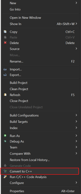

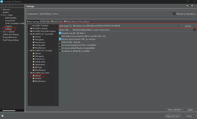

As workaround, you can point manually to the desired linker file:
and convert the code to C++
Thanks.
Mahmoud
