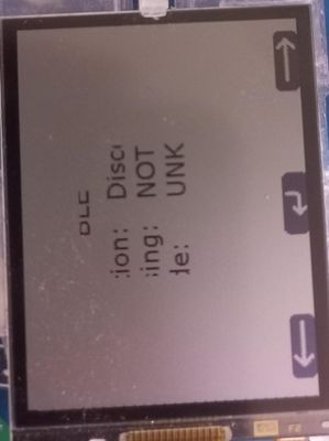

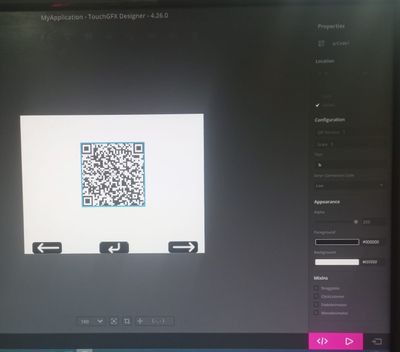

I am new on TouchGFX and UI making, i have make many screens with transition in between i want to add a qr Code,
But when I just add a default qrcode no edit, but it dont show any thing, on that screen but when i change screen to different one and come back again the previous screen content print on qr code area.

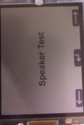

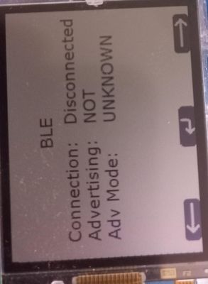

First screen:

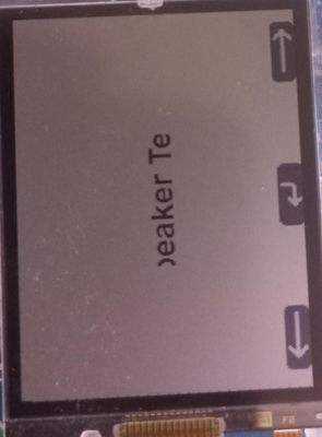

Qr screen: in the qr area the previous screen pixel shown
Qr next screen: when we go to next screen and again come back it again shows same issue.

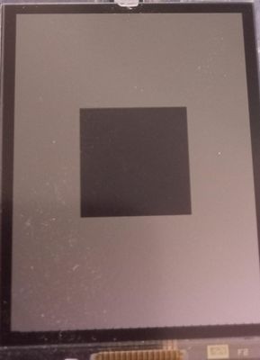

or if we set the qr screen as startup it shows black completely in the qr region.
