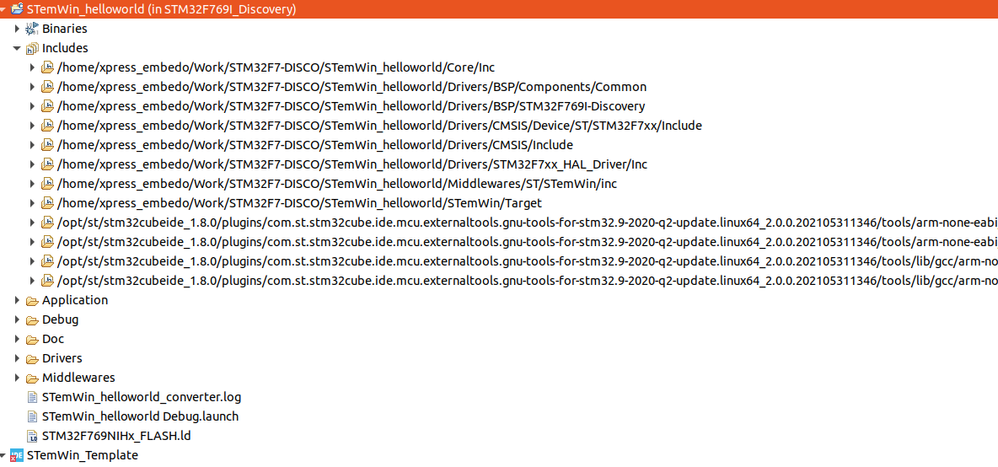

../STemWin_Config/GUIConf.c:54:10: fatal error: GUI.h: No such file or directory
54 | #include "GUI.h"
compilation terminated.But in my project this file is present and added to the project, even the path is also updated in the project settings, I don't know why I am getting this error, that this file is not present.
One strange thing which I have noticed is as shown below, here in include section I can see most of the include paths related to STemWin are disabled/greyed out, I don't know what is the reason.
While the example project which is working fine, this is not greyed out/disabled.
Maybe the issue is related to this.

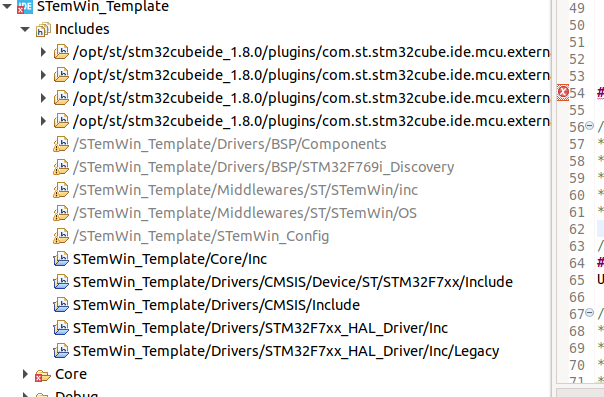

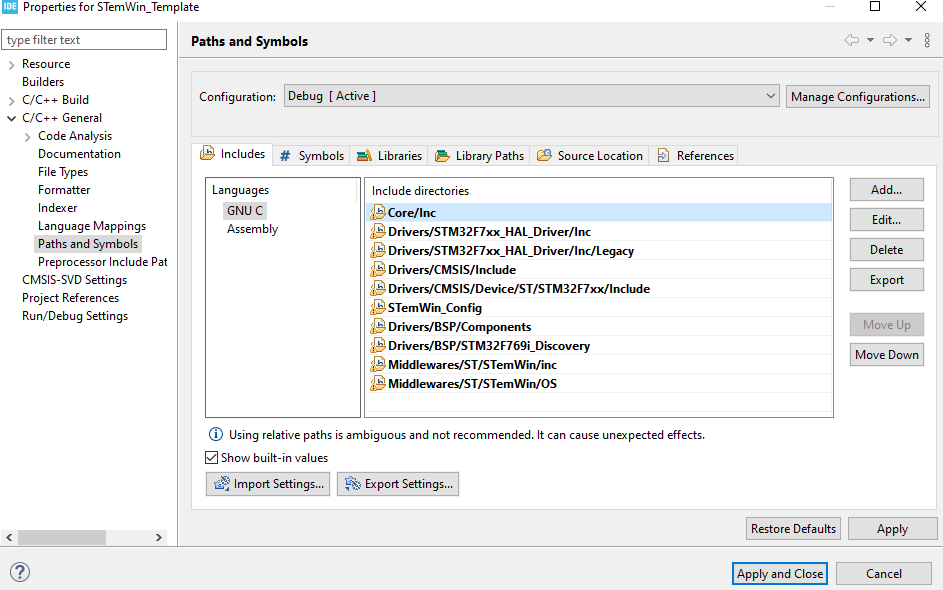

Okay, I was able to solve this problem (I am still getting some other build errors, but not related to this, which I will fix in sometime).
I observed properly and found that when I added path they are added as "/STemWin_Template/...." but if we see other include paths which are not greyed out, it's without the project name, so I just removed "/STemWin_Template" and I am not getting this error again.
So I updated as below.
Now I have few other issues which I will try to resolve. Thanks

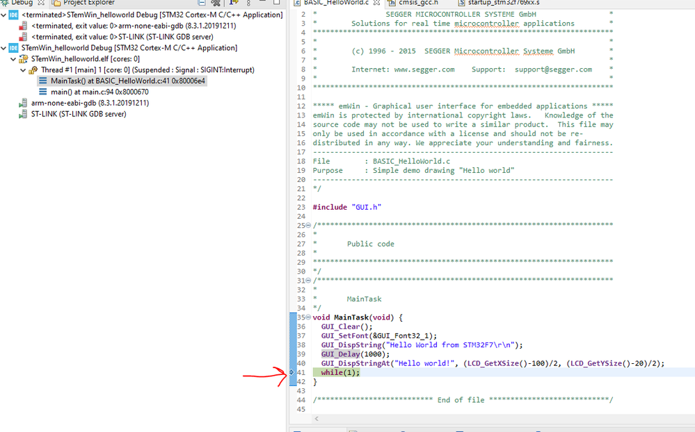

The issue is as below, if I single step while debugging my project, nothing gets displayed on the display. But if I press F8 (run) then it works fine.
void MainTask(void) {
GUI_Clear();
GUI_SetFont(&GUI_Font32_1);
GUI_DispString("Hello World from STM32F7\r\n");
GUI_DispStringAt("Hello world!", (LCD_GetXSize()-100)/2, (LCD_GetYSize()-20)/2);
while(1);
}Another issue is that, if I put a delay like HAL_Delay(1000) or even GUI_Delay(1000), and now even I press F8 (run), then nothing gets displayed after that delay, while control reaches while(1), example is given below

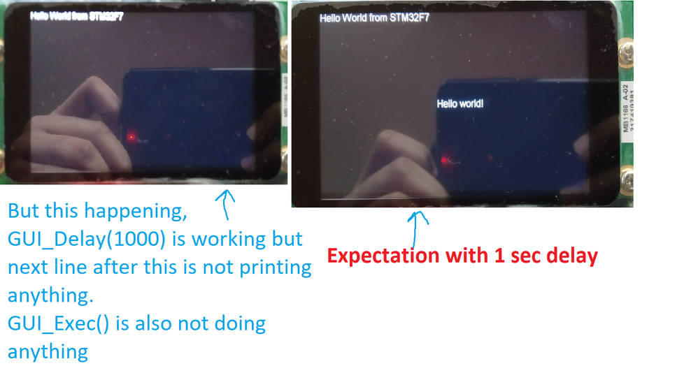

But maybe I am not very much clear in my last post.
As suggested by you, I am already using the "STemWin_HelloWorld" example from the CubeF7 MCU package.
And it works fine (also the project I created taking this as reference works fine).
I have two problems (this problem is also present in the STemWin_HelloWorld example.
GUI_Clear();
while(1);
}void MainTask(void) {
GUI_Clear();
GUI_Delay(1000);
while(1);
}I can see "Hello World from STM32F7" but not the "Hello World" on the middle of the screen. I have attached the picture also.
Right Side image is when I didn't used GUI_Delay and didn't use single step debugging.
Left side image is when I used GUI_Delay, GUI_Delay is doing it work can be seen from the below screenshot, my control is reaching the while(1), so it means GUI_Delay is not blocking the GUI_DispString function call.
Also regarding the points you mentioned that GUI_Init must be called and CRC should be enabled is already done. And since this is the example from CubeF7 package, I just modified it to include Delay and another Display String line.
Do you have some suggestions here now?

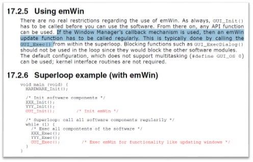

Did you try the Windows Manager?
“GUI_Delay�? API calls internally “GUI_Exec�?. The call of “GUI_Exec�? regularly is recommended to update the modified windows.
“GUI_Exec�? API send notifications to STemWin callbacks and update all invalidated windows.
Thanks for detailed explanation, my understanding was that GUI_Delay uses GUI_X_Delay and GUI_Exec functions internally. And I will share one scenario with you.
Below is the program, where I wanted to display three Hello World message on the LCD Screen, and as I mentioned in the previous post that when I used GUI_Delay function, the emWin API which I use after the delay doesn't work.
So, in this case I just "Hello World-1" message on the screen (If I remove delay I get all three messages)
GUI_Clear();
GUI_DispString("Hello World-1\r\n");
GUI_Delay(1000);
GUI_DispString("Hello World-2\r\n");
GUI_Delay(1000);
GUI_DispString("Hello World-3\r\n");
while(1)
GUI_Delay(100);
}Assuming that GUI_Delay(1000) is equals to GUI_X_Delay(1000) + GUI_Exec(), the above program can be breakdown as.
GUI_Clear();
// GUI_Delay(1000);
GUI_X_Delay(1000);
GUI_Exec();
// GUI_Delay(1000);
GUI_X_Delay(1000);
GUI_Exec();
while(1)
GUI_Delay(100);
}but now I modified the program like below. Here I give a delay, and then used emWin API to display "Hello World-2" on display and then used GUI_Exec function.
GUI_Clear();
GUI_X_Delay(1000);
GUI_Exec();
GUI_X_Delay(1000);
GUI_Exec();
while(1)
GUI_Delay(100);
}And in this case I get "Hello World-1" and after 1 second delay "Hello World-2" but no "Hello World-3"
This means that first call of GUI_Exec does it work, but after this it doesn't work. I don't know the reason, just sharing whatever I find here and did till now.
And my understanding is that, it might be due to the same reason when I do single step debugging I am not able to see anything on display.

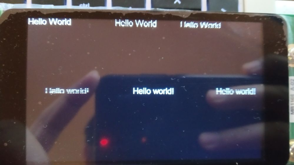

So, I opened the STM32F769I-EVAL STemWin_helloworld example, and without analyzing took the risk to compile and program on my board.
And guess what happen I can see two times string with some 1 second delay, which I programmed.
The below is the program I used.
GUI_Clear();
GUI_DispString("Hello World\r\n");
GUI_Delay(1000);
while(1);
}The output is not perfect, I can see some strangely printed text ("Hello World"), which I assume for the obvious reasons because they have some different pin-outs (I checked this later by comparing LCD configurations of both projects).
I requested them to re-check on the STM32F769I-DISCO board and not on STM32F769I-EVAL board.
Because the board I have is brand new and pre-programmed demo works really fine here, so I doubt there is some configuration issue, which for me might be very difficult and will take more time to analyze and fix, but since you guys are experts you can find and fix them really easily.
The point is GUI_Delay function works really well in other project but not here, which to me looks like some configuration issue.
So now I am waiting for the feedback from them also, and in case you have some information you can also share with me.
Thanks in advance.
