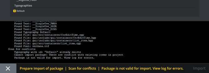

Cannot import package: Typography with id: "Default" already exists
ferro
Lead
Do you know what I am doing wrong ?
Thanks

So before export, changing Typography name used by the Custom container from 'Deafult' to let say 'DeafultExp' resolved this issue.
Hm, so there must be as many different Typography names as number imported Custom containers ?
Gfx understands that the 'DefaultExp' and 'Default' are the same Fonts and asigns them the same Id:

Hello @ferro ,
I previously had this error message when  importing custom containers (tpkg files).
Basically, when exporting a custom container using one of the default fonts (default, large and small), when importing it to a project already having the same font names, there will be this error message.
A good practice is then to change the name of the typographies ( ~= font names) to not have this erroe message.
This seems to be what you have done to solve the issue yourself (c.f. your previous message).
I invite you to select either my comment or you comment as "best answer" to make it easier for other users to find the right answer to the problem.
Regards,
Gaetan Godart
