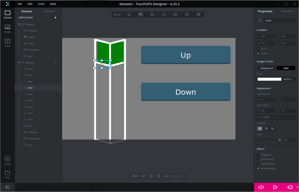

It looks like a vector image with a few straight and a few diagonal lines. You can use inkscape to draw the vector image and then export it as svg or as png. So a single image.
Another solution is to use the line object in TouchGFX. The floors are 3 vertical lines in total and 2 diagonal lines per floor (+ 4 extra for top floor).

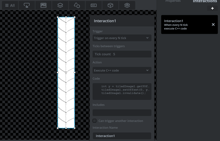

Is it possible using custom container.?
My tip start with tiled image + Special image on top + cabin image ...
read Tiled Image | TouchGFX Documentation
