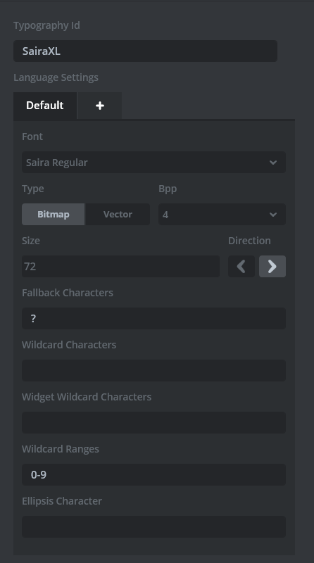

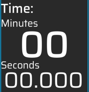

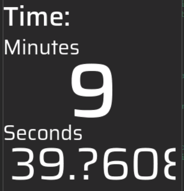

I created a timer for a display using two text areas. One is a text area with a single wildcard (i.e. minutes), and another is a text area with two wildcards (i.e. seconds). It runs fine for ~9 minutes and 4 seconds but then suddenly the text area with two wildcard randomly generates a ? on the second wildcard, and this occurs on both the simulation and on the hardware that I am running. The typography has the 0-9 wildcard ranges, for all font sizes used. There are rare occasions when the question mark (?) goes away, but I do not know at what time that occurs. Any help is greatly appreciated.

Hello @Enginerdy ,
You set your counter as int_16 which range from -2^15 et 2^15, so the maximum value is around 32 000.
The issue happens after 9 minutes and 4 seconds and every second has 60 ticks:
((9*60)+4)*60 = around 32 000
So you simply go to negative values after that.
To fix that, you should reset your counter after every second and increase your second counter, then only increase your minute counter when you are at 650 seconds and set back the seconds to 0.
