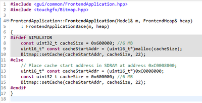

And i have created a 6MB cache in FrontedAplication.cpp which can print my image like 21 times.(I use the same image for debugging but later on they will have different images)

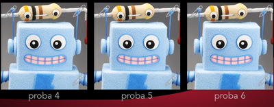

And everything works perfectly but once a amount of ticks has passed, this is what happens to the images:
They dissappear, and i don't know what is causing this. I'd like to debug or be able to see whats being stored in the cache or if clearCache() is really removing the images from the cache, but I have no way to do this right?

This is a simulator project so i don't really know how I can enable or disable D-Cache, but until I declared this in the FrontedAplication.cpp the images wouldn't show, so it must be storing them in this cache:
Also if I try to print all of them i only see like 20-22 of the images, and if i reduce the cache declared in there it does show less images, so it's storing them there

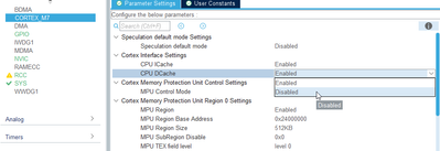

You can disable cache in the ioc file (STM32CubeMX) here :
I assumes you were using a H735 as you said you used this MCU in previous posts.

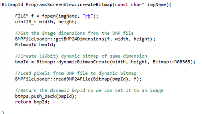

The createBitmap function just creates a dynamic bitmap and then returns its id.
If i print the bitmapId's i can see that it creates and deletes the 12 images in every loop, basically it prints bitmap ids from 58 to 70, and when it crashes it displays bitmapId: 65535 which if i'm not wrong is just the bitmap invalid id.

I figured that the size of the 509 call was wrong (value width and height in the getBMP24Dimensions function).
By manually changing those values to the pixel size of your image (240 x 240) I am not encountering any error anymore.
width = 240;
height = 240;
This is just a quick walk around that would work if all of your images are the same size.
