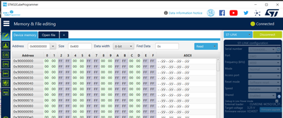

Then I download the code with CubeMXProgrammer and read back the 0x90000000 which is mapped to QSPI external flash. The representation of the png in the flash is as follows:
The CPP file and the flash contents seems overlapped to me. And when I run the code and read the frame buffer:
It is still overlapping. But I am seeing color of CYAN instead of RED.
