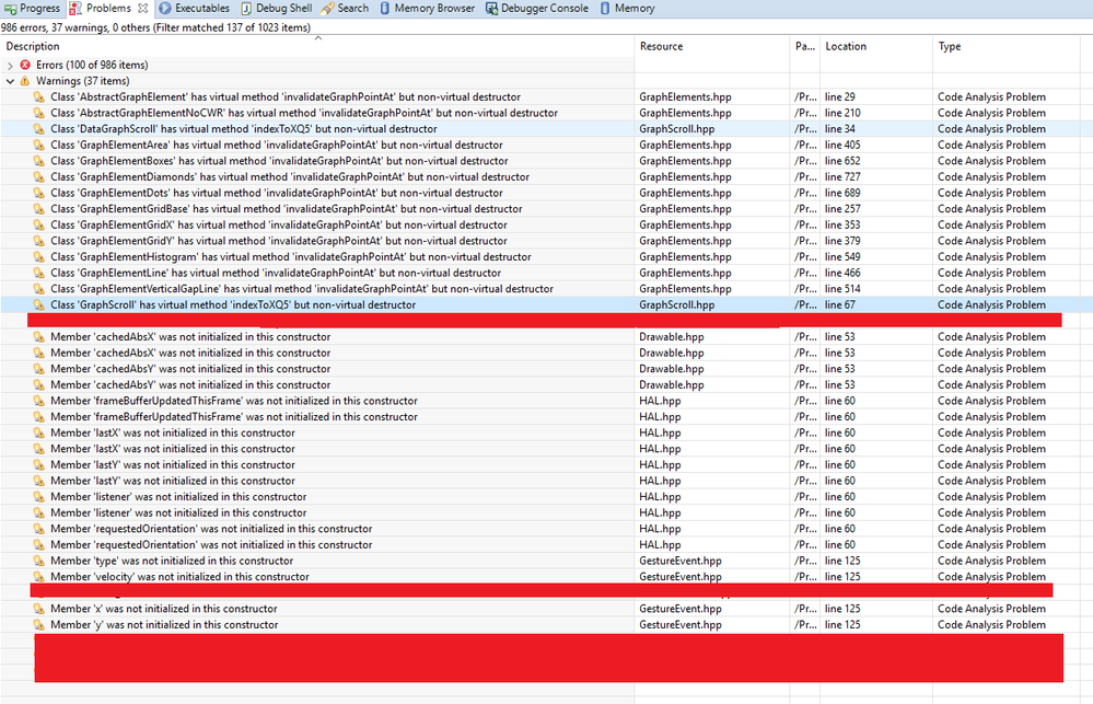

Also everywhere in this code, at least our linter, is saying there is no virtual destructor declared anywhere for any *Graph classes, but it has not caused trouble for us yet, so we have not done anything regarding this...
2021-01-18 1:51 AM

Dear VSimu.1
Can you please be more specific. When I check the source code for TouchGFX I find that
class DataGraphWrapAndClear : public AbstractDataGraphWithY : public AbstractDataGraph : public Container : public Drawable which has a virtual destructor.
class GraphElementDots : public AbstractGraphElement : public CanvasWidget : public Widget : public Drawable which has a virtual destructor.
Since we might roll out a 4.16.1 soon, if you can be more specific, we might be able to look into this and include a fix in 4.16.1.
1) Which specific class is reported to have the problem?
2) Which linter are you using?
3) Are you actually casting a pointer to a base class before deleting it - otherwise it should not cause any problems. TouchGFX does not use dynamic allocation, so there is no problem there.
Thanks for taking the time to report these problems to us.
Regards,
Søren
2021-01-20 4:45 AM
Dear Søren,
Okay thank you for the information.

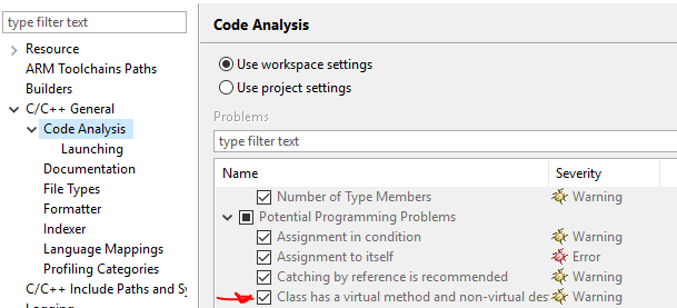

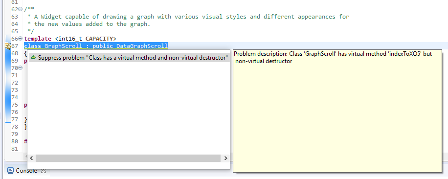

Answers to your questions:
1) GraphScroll
2) I do not know this. I do not even know where to find this. We use Eclipse and the code linter that checks the source files there shows this. See screenshot:
TouchGFX only had "Warnings". Nothing was in "Errors" tab.
3) Okay. I do not think that we are for this case. But maybe that may change? We are also not dynamically allocating anything either, we are trying to avoid using "new" if possible.

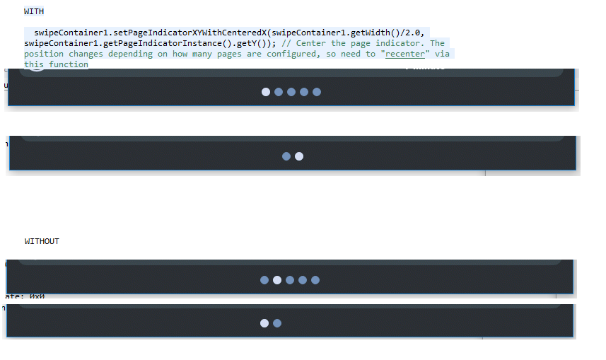

I do actually have 1 further feedback point. Since you mentioned you will be doing a 4.16.1 release soon. We were happy to find in 4.16.0 that the SwipeContainer.hpp file got a new public function "uint8_t getSelectedPage() const;". We were hard-coding this ourselves because we needed it. But now we do not have to modify touchgfx because of this. Because touchgfx now provides this function.
But, we are still modifying the touchgfx library for something else. Inside SwipeContainer.hpp, we add this one-liner to the end of the class:
public: const PageIndicator& getPageIndicatorInstance() { return pageIndicator; }
We want read-only access to the PageIndicator of the swipe container. The use case is the following. We statically create in TouchGFX Designer 5 Pages in the swipe container. But based on application configuration, we simply "remove" pages, if we do not want so many. This makes the "Page Indicator" not horizontally-centered. So then we added this one-liner to take care of that, which explains our need to modify SwipeContainer.hpp again:
swipeContainer1.setPageIndicatorXYWithCenteredX(swipeContainer1.getWidth()/2.0, swipeContainer1.getPageIndicatorInstance().getY()); // Center the page indicator. The position changes depending on how many pages are configured, so need to "recenter" via this function. You see we just want the Y-coordinate to stay the same. We do not want to change it. But this is the only way to get what the Y coordinate value is. All we are interested in is horizontally-centered.
So what I am trying to say is: if you can add "public: const PageIndicator& getPageIndicatorInstance() { return pageIndicator; }" to 4.16.1, that would be nice.

2021-01-20 7:01 AM
If you use SwipeContainer::remove(page), does the pageIndicator not get repositioned and centered properly?
Regards,
Søren
2021-01-20 7:44 AM
Just tested it to make sure (I did not test with 4.16.0 before you asked). It does not reposition the pageIndicator after SwipeContainer::remove(page).
You see, without the code that I mentioned, the pageIndicator just stays fixed at the same XY position. Regardless of how many pages I remove. The only reason "5 pages" looks good, is because I statically set 5 pages in TouchGFX Designer. So in that case it does not make a difference.
But maybe if you have the code that I wrote previously, at the end of your SwipeContainer::remove() method, then that would work.
