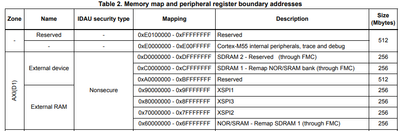

Yes, the address is determined by the XSPI peripheral. You can see the addresses in Table 2 in the reference manual:
The main consideration when placing framebuffers in external rather than internal RAM is bandwidth. Internal memory offers higher bandwidth due to both higher speed and better efficiency. Whether this matters in practice depends on your display resolution and the amount of pixel operations you perform.
The TBS for the STM32N6570-DK available in TouchGFX Designer is already prepared for using framebuffers in external PSRAM, so you can use it as reference. Remember to set up the correct MPU configuration when using external RAM.
