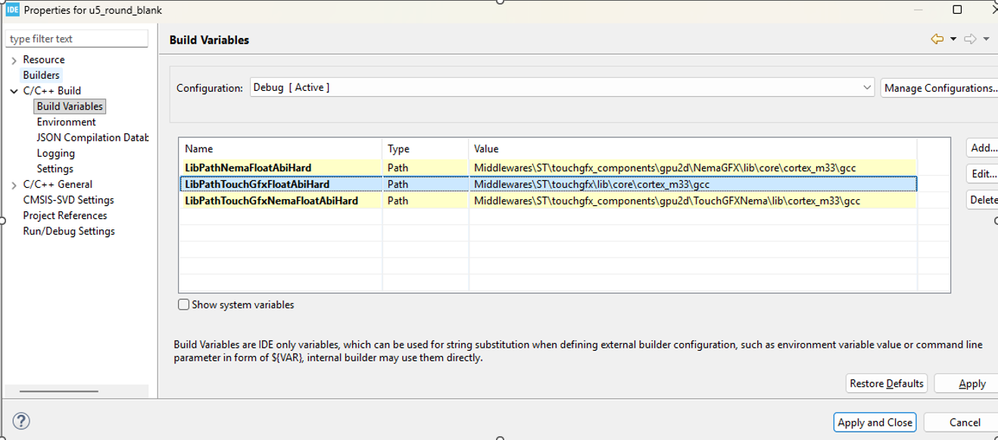

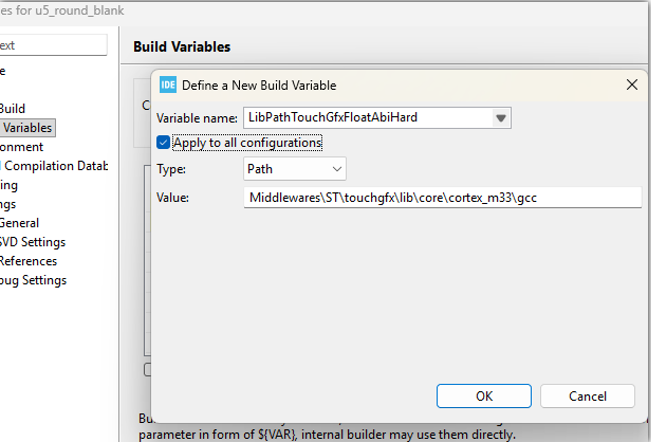

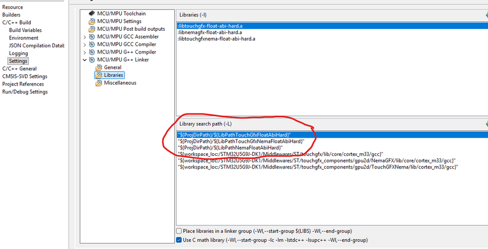

Create build variables pointing to libs so that GfxDesigner does not overwrite.
Example how to create a variable
And now, create linker lib paths using those build variables
"${ProjDirPath}/${LibPathTouchGfxFloatAbiHard}"
"${ProjDirPath}/${LibPathNemaFloatAbiHard}"
"${ProjDirPath}/${LibPathTouchGfxNemaFloatAbiHard}"Tyou should see this

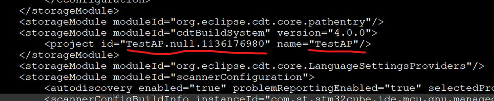

Or try a simpler fix compared to my previous post.
You need to change project name in .cproject as well - that is where GfxDesigner fetches project name to point to libs.
Go towards the end of .cproject and change 2 places where old project name is

"I'm confused at what we're solving now."
We are solving Gfx overwritinh the lib search paths in .cproject. I solved this issue few days back, I looked into my notes and I changed .cproject at the end (you hve done that) and then I deleted lib paths in CubeIDE. After I ran GfxDesigner new paths were ok. Could you try to delete in CuebIDE ?
