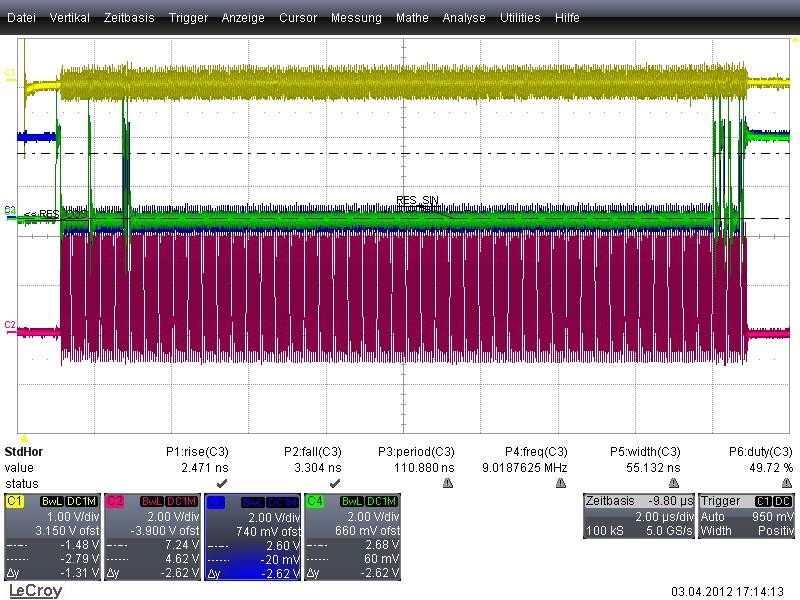

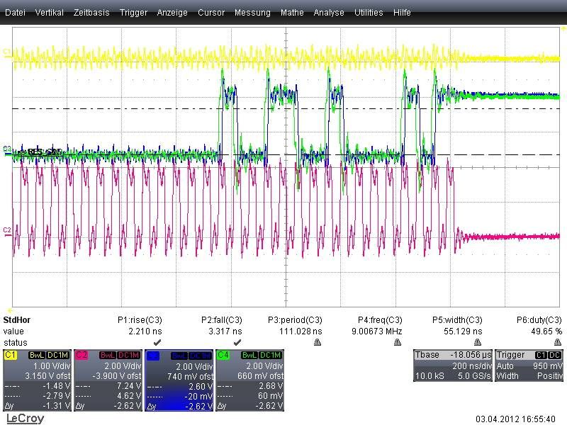

I've interesting behavior on STM32F105VC. I have SPI3(remmaped) master with SPI auto CRC calculation (RXCRC,TXCRC). For 9Mhz it is fine, for 18Mhz I receive all words correct, including
CRC, but RXCRC register is wrong and CRCERR is set. See below 18 MHz result2012-04-03 7:18 AM
One good news: If I switch off a slave and connect MISO with MOSI on master, everything is OK.

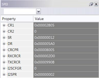

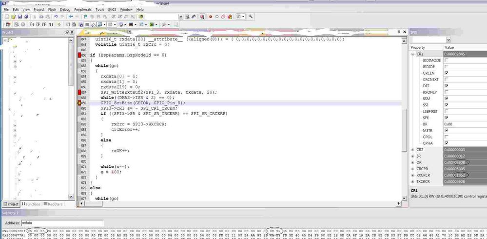

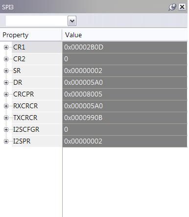

I am sending a same frame in both directions: tx16b[20] = {4,5,0,...0}, for tx last two contains a crc. I have debugger on a master. I've two breakpoints one before SPI enabled(Tx start) and one in the DMARx interrupt (TX finished). I see an interesting behavior of the RXCRC:
Step RXCRC 1 0x854D 2 0x8C87 3 0x0514 4 0x0514 ... I can reproduce this RXCRC error sequence. Again received data are ok:(2012-04-05 11:25 AM
Well the 0x990B computation now make sense.
Problem here is I can't see how you're handling the DMA, and setting the SPI_CR1_CRCNEXT at the appropriate point in the transmission. The ST example CRC code doesn't use DMA, but does some very specific sequencing of data, and setting of CRCNEXT after the last word signals TXE. Less magic is involved on the RX side, provided the RXCRC is clear prior to reception, the value of RXCRC after the total payload including CRC (ie 0x990B) should be ZERO, indicating the data divided into the polynomial completely without a remainder. My best guess is that you DMA the first 18 words, and in the TC interrupt you check the SPI TXE flags, and then SPI_I2S_SendData() the last data word (19), and then set the CRCNEXT, which will cause a 20th CRC word to be sent immediate afterward. Also remember that TXCRCR will not contain a valid value until all 16 bits pending have been clocked through it. I would imagine if you read RXCRCR will also contain indeterminate data if all the in-bound bits have not come in completely, or it starts on another word.We’re moving the ST Community to a new platform to give you a better and more reliable community experience.
