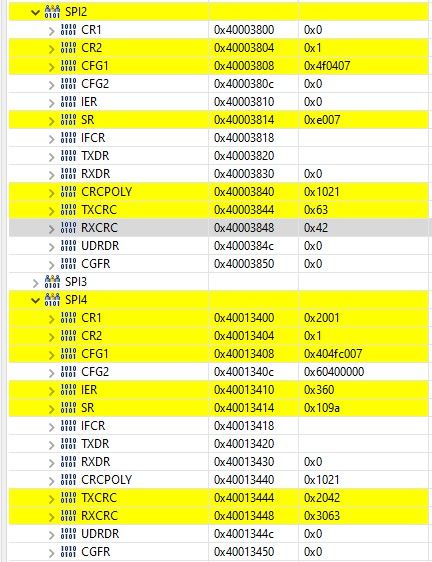

When I enable the CRC, I always get CRC errors. For testing I send only one byte in each direction. When I look into the SPI registers, the RXCRC and TXCRC registers for SPI2 and SPI4 hold different values. It looks like the CRC of SPI2 is truncating the calculated CRC value.

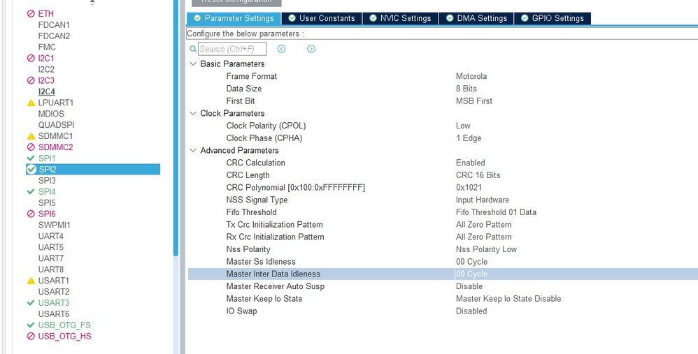

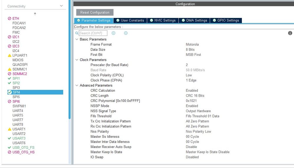

Here is my configuration

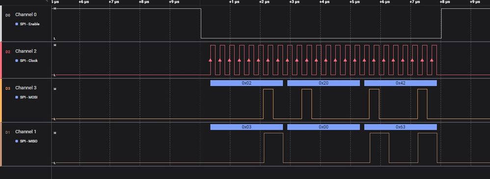

Here are the values on the bus, the first byte is the payload for testing (master sends 0x02, slave 0x03):
When I get the error callback, I get these values back:
My expected crc values are 0x2042 for payload 0x02 and 0x3063 for payload 0x03.
SPI4 calculates the correct values, but SPI2 seems to truncate the leading byte.
