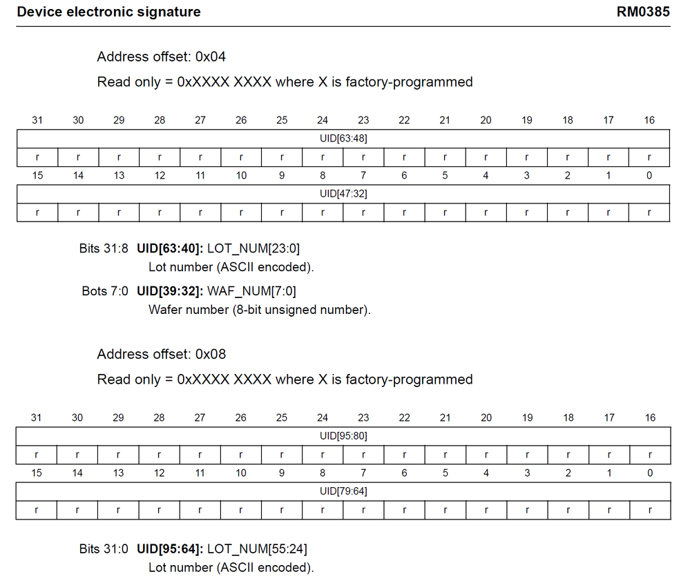

2021-08-25 2:09 AM
Is perhaps some voltage out of range?
2021-08-25 2:32 AM

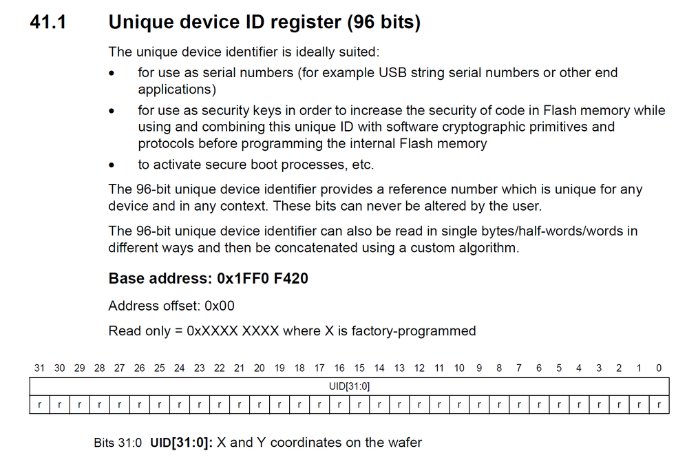

Might be worth looking at and comparing HSICAL/HSITRIM between good and bad boards, although I don't think a 12% swing is possible.
Also the UID includes die position, which can show if the bad boards were from a different lot. Chips on the same wafer have almost the same UID.

2021-08-25 8:33 PM
> The package IDs :
The unique IDs are written on the chip in FLASH, not labeled on the outside of the physical package (although some info will be equivalent).
I would open a support ticket with ST if I were you. Seems like something is off.

2021-08-25 10:40 PM
Dear TDK
Thank you for your reply.
First thank you for the description. I didn't understand it indeed.
After coding a readout I get for a board:
Except for X/Y coordinates that change for every chip, the same values across 16 and 18Mhz boards.
Wafer 48 of LOT P0P35 (hope I converted that correctly)
The coordinates however are quite close to each other as X or Y is sequential in the readings
16Mhz chips is Y 44,
18Mhz chips are Y 40,41,42,43 and so on
