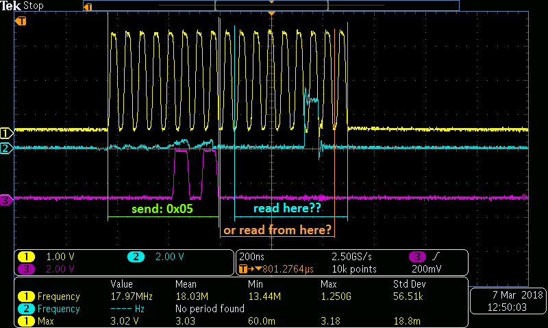

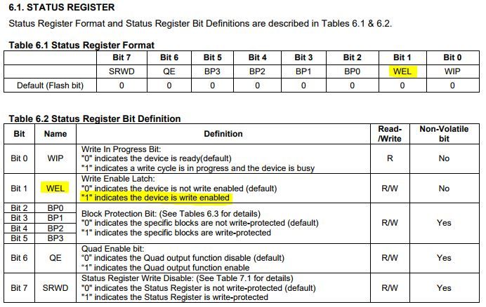

And now, I send 0x06 write enable and read status register 0x05, where 0x06 is sent only once.
You can see on the picture:
But autopolling doesn't match:
QSPI_AutoPollingMode_Config(0x02, 0x02, QSPI_PMM_AND);
I I don't know, what is true? blue or orange? Because, receive datas have 9bits....
And I'm waiting on this line:
while(QSPI_GetFlagStatus(QSPI_FLAG_SM) == RESET){};
2018-02-08 12:10 AM
Hello.
My problem was in connection cable. I moved my receive pin on 1 position.
