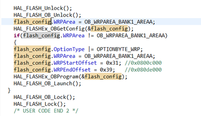

When I Update WRP option bytes in stm32u585 via program and call OB_launch is resetting device continuously.
Here is the code snippet.
any other configurations I am missing??

Got the answer need to add check before changing it:
