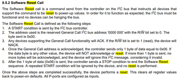

In datasheet also they mentioned how to do with software.but i am conused about implementation.
Since I am reinitializing the i2c in above code,i2c lines are active so,can I do softreset

uint8_t reset_command = 0x06;
HAL_StatusTypeDef status = HAL_I2C_Master_Transmit(&hi2c3, 0x00, &reset_command, 1, 100);

The software reset mechanism involves a normal write transaction to the chip, which is not possible when SDA is held low, so it can't help you here. However, if you bus is functioning normally, send a single 0x06 byte to the 0x00 slave address to reset the chip.
uint8_t data = 0x06;
HAL_I2C_Master_Transmit(&hi2cx, 0x00 << 1, &data, 1, HAL_MAX_DELAY);
