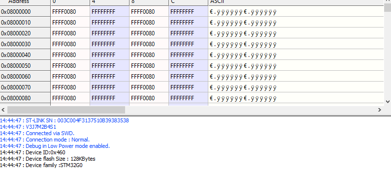

Currently developing a product to update the firmware of a product through SWD, i encounter an issue with the flash of the target (STM32G070RB).
After multiple changes in the RPD (from 0->1 & 1->0) the flash of the MCU can't be erased.
Some word will not erase to 0xFFFFFFFF, but instead will be at 0xFFFF0080.
Once it's in that state, changing the RDP to trigger a mass erase will not fix the flash. The STLink is unable to mass erase or page erase the chip, and also unable to program anything to the chip.

When the bug occured the RDP change worked as expected changing from 1 to 0. But the mass erased triggered by the RDP change failed to erase the flash properly. Instead of that the whole flash is a set to 0xFFFF0080FFFFFFFF.
When the MCU is in this state i can still change the RDP using the STLinkUtility. From RDP0 to RDP1 and RDP1 to RDP0, without issue, except for the flash.
When trying any type of erase using the STLinkUtility i encounter an error. Same when trying to program the MCU.

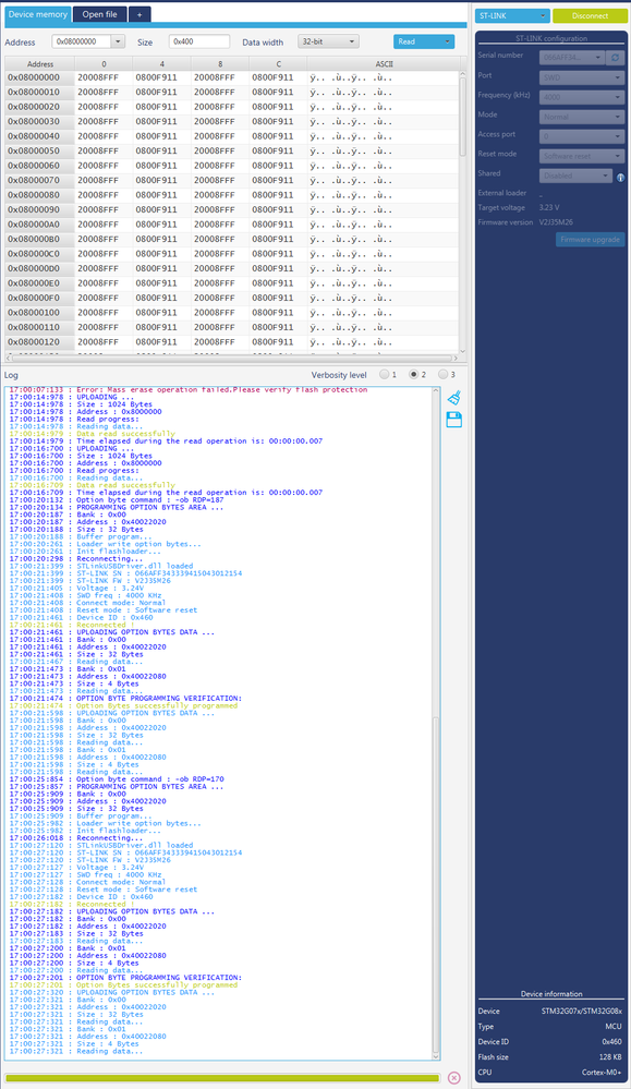

Ok so after soldering the last faulty STM32G070RBT6 to a NucleoG070, and using STM32CubeProgrammer i obtained interesting result:
-The flash read initially returned the same values i had with the STLinkUtility (0xFFFF0080FFFFFFFF)
-Chip Mass Erase returned an error
-RDP changes are working, BUT after few changes the flash changed value, as you can see in the next screenshot:
Nothing else changed. The flash is still stuck in this state. Can not program/erase the chip.
