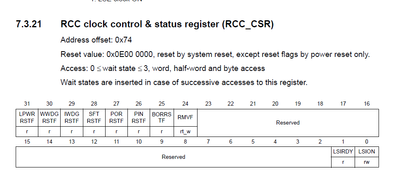

For that he needs to check the RCC_CSR register:
