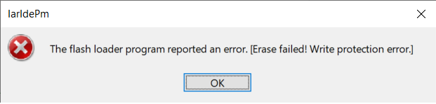

I have flashed the SBSFU application with write protection enabled for flash address 0x08000000.
After that, I am unable to erase using jlink commander.exe as well as by IAR->project->Download->erase.
STM32H743 has SWD interface and i am using jlink debugger for connection.
I am able to connect jlink debugger. But i could not erase it.
Please suggest me how to erase the flash of STM32H743II.

Hi Belaid,
I am unable to connect with cube programmer through jlink debugger. It is custom board doesn't have onboard ST debugger. Any other way to erase the flash through jlink debugger?

2023-03-26 11:44 AM
I tired with STM32 unlock command line tool. But it is failed to make in default factory setting
