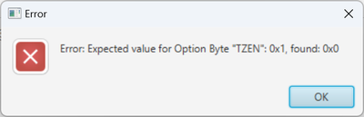

Again I have not actually clicked send in this scenario in case CubeProgrammer actually does it.
Note that in all scenarios, the option to "debug in Low Power mode" is checked.

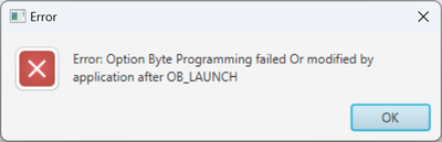

The primary issue seems to be this -- user applications that use low-power modes can really confuse CubeProgrammer. When CubeProgrammer must allow the target to run (eg, during hotplug connect or OBL launch), the target might use low power and quietly break access to the option bytes and maybe more. At this point I'm still only guessing that these issues allowed me to brick the 'U585.

If you want to try the 7-step scenario I shared above, which does not use hotplug mode, then please use the attached application firmware on a U585 IOT kit. You will see how easy it would be to accidentally trash the option bytes - which can easily brick the device. A user might simply "try again" to set TZEN after getting the error messages, and unwittingly send a bunch of zeros for the option bytes. (FYI, the attached application blinks the LED and sends UART output. It uses low-power sleep almost all the time, and it doesn't use stop/standby modes.)

OK I get your point. With your application, as you use SLEEP state immediately after startup, the STM32CubeProgrammer is not able to reconnect after setting option bytes, probably because this is not an initial connection. This results in an error and option bytes are set to 0.
I will raise the point internally.
