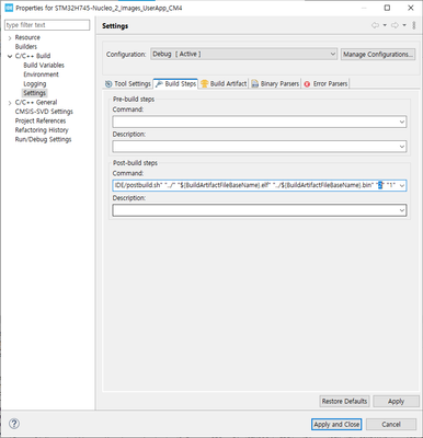

Although cm7 is operating normally, I created a separate cm4 package, created an sfb file, and confirmed that the cm4 firmware was installed in dwl_slot2. However, the firmware needs to be moved to active slot 2, but I have no idea how to do it. How to solve this?

the SBSFU should recognize the firmware in download slot 2 as a "slot 2" firmware.
For this, you need to provide this slot number in the postbuild command the generates the sfb file. This is the parameter that is just before the version number.
You can see the result in the header of SFB file : First 4 bytes should be SFU2 instead of SFU1

I'm get a Error message.
prepareimage.exe enc -k ../../../2_Images_SECoreBin/STM32CubeIDE/../Binary/OEM_KEY_COMPANY2_key_AES_CBC.bin -i ../../../2_Images_SECoreBin/STM32CubeIDE/../Binary/iv.bin ../UserApp.bin ..//../Binary/UserApp.sfu : failed

I finally made SFU2 Image but cm4 can't boot...
