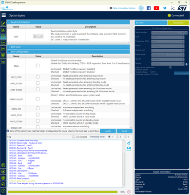

I received another U585 IOT kit and did some experimenting. It appears my specific issue is that CubeProgrammer does not handle low-power modes correctly. Here's what it looks like after a hot-plug SWD connect to a target using low-power sleep:
There are no error messages and no indication anything has gone wrong. But the option bytes shown are not correct. And the application on the U585 continues to run -- which is odd considering CubeProgrammer indicates it is "connected" to the U585. I suspect in my experimenting a few weeks ago I didn't notice the problem and clicked "Apply" after making some minor change. In fact I think I remember wanting to experiment with enabling TZ *after* setting RDP to level 1. So I may have click the TZ check box and clicked "Apply". Option bytes set this way would explain my having a bricked U585.
I would rather not try it again on my new kit ;), but I think this explanation is plausible.
