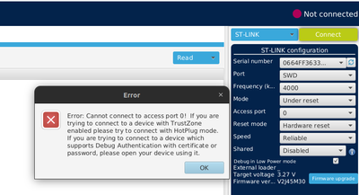

I've made this post because the hot plug mode connection also did not work out :)

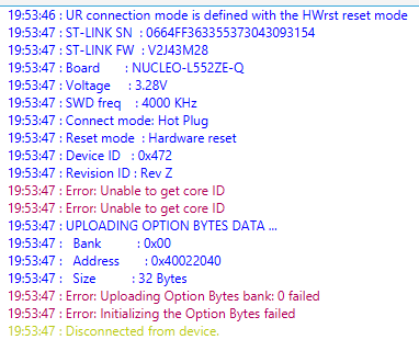

I pulled BOOT0 pin to High (connected CN11 pin 5 to 7), connected the board to the PC and then tried to connect to STM32Cube Programmer using the Hot Plug mode. Here is the output:

So try to find, what state you set - and what you can do , to get back , if possible...

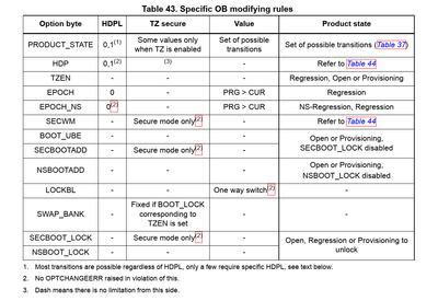

in rm (H563):
And if you locked the cpu and no way to unlock...replace cpu or board - and next time read first, what you might do and if there is a way back.

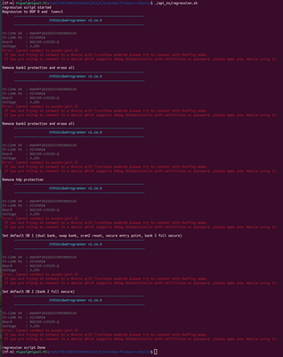

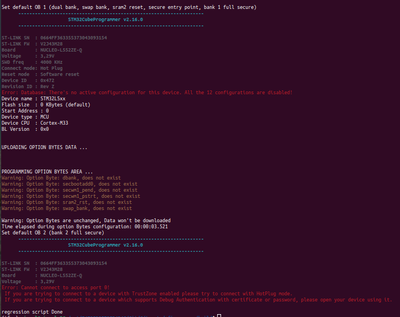

cmake .. -DTFM_PLATFORM=stm/nucleo_l552ze_q -DTFM_PARTITION_PRIVATE_ANN=ON -DCMAKE_BUILD_TYPE=Debug -DCONFIG_TFM_SPM_BACKEND=IPC -DTFM_TOOLCHAIN_FILE=../toolchain_GNUARM.cmake -G"Unix Makefiles"Regarding the second point, removing the option --hrdRst resulted in a different output.

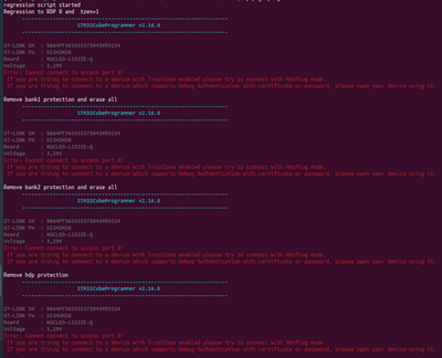

With the option --hrdRst, the regression.sh script returns:
Without --hrdRst, it returns:

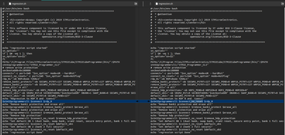

The problem I describe in this post occurred with the TF-M v2.1. with the STM32Cube Programmer v2.16. The regression scripts generated by both TF-M versions are quite similar; however, there is still one change that I highlight below (TF-M v2.1 -> left; TF-M v1.7 -> right). Can this be the source of the error?
