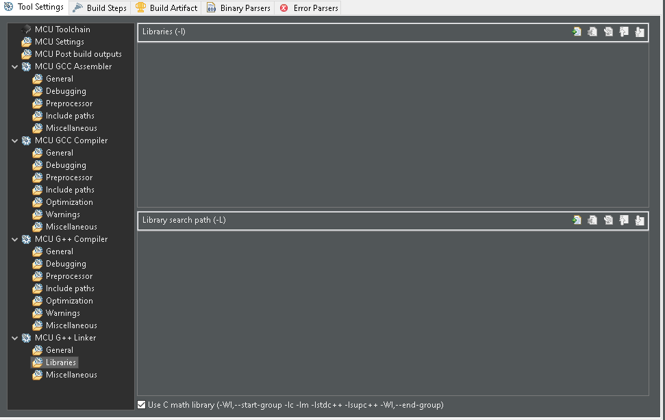

Just adding some infos where I found these options
click right when selecting the project which fail linking
Then properties
Got to C/C++ build setting
MCU GCC linker in Librairies you have entry :se_interface_app.o
remove it but select & clicking on the red cross icon
then select MCU GCC Linker/Miscellaneous
add -l:se_interface_app.o (please note the -l before)
Wait a bit for build and enjoy
Problem is solved
Vincent
2021-04-20 9:56 PM
Hi Jocelyn,
i habe in deep the same problem
c:\st\stm32cubeide_1.2.0\stm32cubeide\plugins\com.st.stm32cube.ide.mcu.externaltools.gnu-tools-for-stm32.9-2020-q2-update.win32_1.5.0.202011040924\tools\arm-none-eabi\bin\ld.exe: ../Core/Inc/new_main.h:16: multiple definition of `huart_MHZ19C'; ../Core/Inc/new_main.h:16: first defined here...
But in my case, there is nothing to delete on Libraries
I added the object on the micellaneous and compile agin
Eventhough the changes. i get the same error
I appreciate your comments
