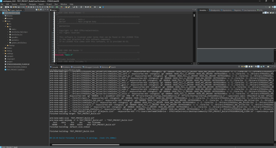

2025-11-26 9:49 AM
I'm using standalone cubeMX version 6.16.0, and cubeIDE version 2.0.0. the complete console output is :
18:47:46 **** Incremental Build of configuration Debug for project test ****
make -j8 all
arm-none-eabi-gcc -o "test.elf" @"objects.list" -mcpu=cortex-m33 -T"/home/zach/Dev/test" --specs=nosys.specs -Wl,-Map="test.map" -Wl,--gc-sections -static --specs=nano.specs -mfpu=fpv5-sp-d16 -mfloat-abi=hard -mthumb -Wl,--start-group -lc -lm -Wl,--end-group
/opt/stm32cubeide/plugins/com.st.stm32cube.ide.mcu.externaltools.gnu-tools-for-stm32.13.3.rel1.linux64_1.0.100.202509120712/tools/bin/../lib/gcc/arm-none-eabi/13.3.1/../../../../arm-none-eabi/bin/ld: read in flex scanner failed
collect2: error: ld returned 1 exit status
make: *** [makefile:64: test.elf] Error 1
"make -j8 all" terminated with exit code 2. Build might be incomplete.
18:47:47 Build Failed. 2 errors, 0 warnings. (took 115ms)
