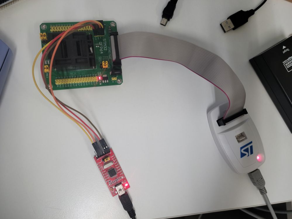

when RDP is disabled, Firmware sends data like the pic below
However, RDP is enabled. I cannot see anything.
How can the firmware work when RDP is enabled?
I'm using QFP 64pin socket & connected Jtag by ST-Link v2.

I see on the picture that you are using a breakout board, find the RESET pin and pull it to ground for a short time.
