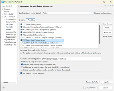

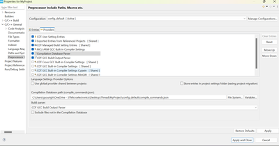

Hello @pmndt
First you need to tick the option " CDT GCC Build Output Parser " as shown in the following screenshot
Then go back to "Compilation Database Parser" and in Build Parser tab : select "CDT GCC Build Output Parser" as shown below
then apply and close.
THX

Hello @pmndt
THX
Ghofrane

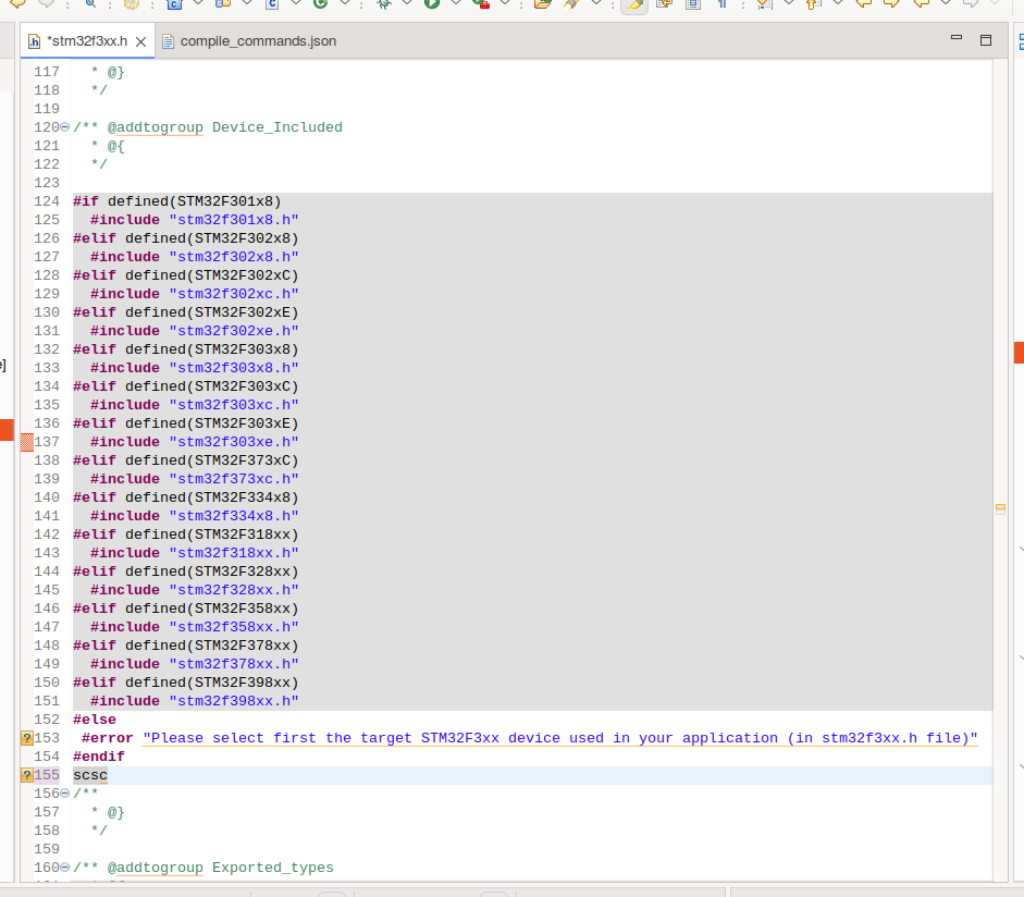

2026-03-09 7:20 AM - edited 2026-03-09 7:24 AM
I followed your instructions, but the indexer is still not working.
And also syntax highlighting fails (macro STM32F303xE is set):
Any ideas?
Regards,
Norbert
