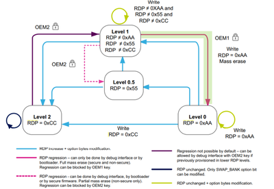

2023-12-20 6:53 AM
Hello @Piranha ,
Indeed the link does not work because it's under maintenance here's the block diagram that i wanted to refer to :
the same information could be found in details in RM 0456 section 3.10.1 Life-cycle management with readout protection (RDP).
