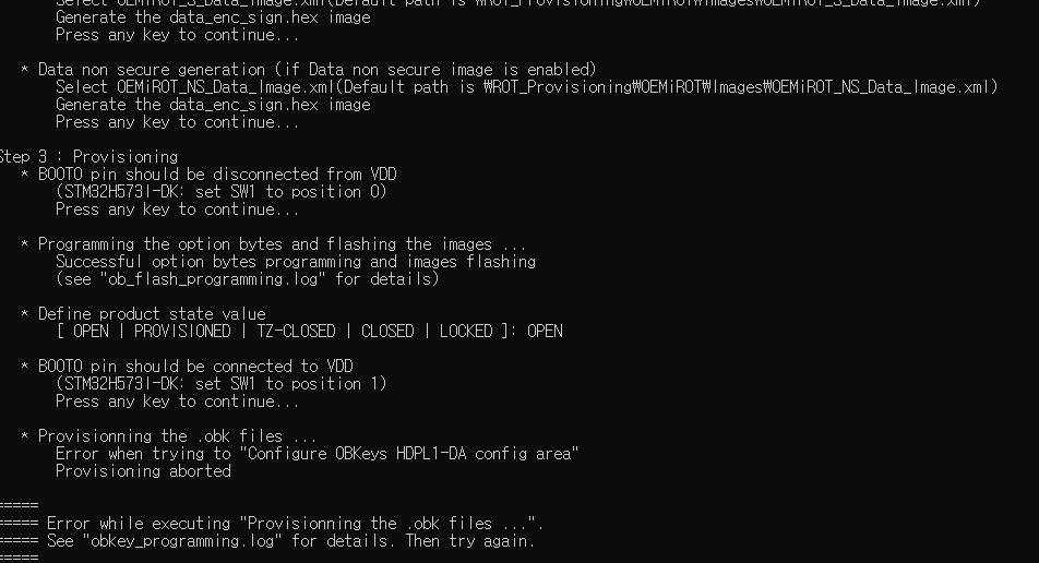

I'm using a STM32H573-DK board for engineering samples.
so. I'm run a example this link but provisioning.bat files does not run at 'Step 3 : Provisioning'
How to fix this problem?

attach obkey_programming.log file contents
C:\Users\user\STM32Cube\Repository\STM32Cube_FW_H5_V1.1.1\Projects\STM32H573I-DK\ROT_Provisioning\OEMiROT>call ../env.bat
Configure OBKeys HDPL1-DA config area
STM32CubeProgrammer v2.15.0
ST-LINK SN : 000600164D46501220383832
ST-LINK FW : V3J13M4
Board : STM32H573I-DK
Voltage : 3.28V
SWD freq : 8000 KHz
Connect mode: Hot Plug
Reset mode : Software reset
Device ID : 0x484
Revision ID : Rev A
Device name : STM32H5xx
Flash size : 2 MBytes (default)
Device type : MCU
Device CPU : Cortex-M33
BL Version : 0xFF
SFSP Version: v0.0.0
Debug in Low Power mode enabled
Hard reset is performed
Voltage : 3.28V
SWD freq : 8000 KHz
Device ID : 0x484
Revision ID : Rev A
Device type : MCU
BL Version : 0xFF
Voltage : 3.28V
SWD freq : 8000 KHz
Device ID : 0x484
Revision ID : Rev A
Secure Data Provisioning Start. OBK Input file : ../DA/Binary/DA_Config.obk
Error: Execution of RSS CMD fail with timeout
Error: call_RSSLIB_SetOBKey Failed
лллллллллллллллллллллллллллллллллллллллллллллллллл 100%Error:
OBKey Provisioning failed

insure to change SW has indicate in the trace and then it should works
Br,
Frantz

2023-12-20 4:39 PM
Yes, my board SW1 already set to FLASH (0)
2023-12-20 5:06 PM
Sorry solved problems, first SW1 set a position 0 and next set 1 finaly set 0.
These processes have not been performed.
