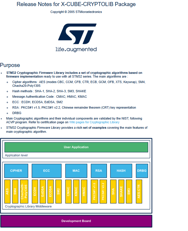

After checking the current release note for XCUBE_CRYPTOLIB(v4.6), i couldnt find ML_DSA as well, in this case i Should wait for the latest package to be released right? Attaching available packages for current cryptolib
Release note CRYPTOLIB
Thanks again for your support
Best Regards
Philip
