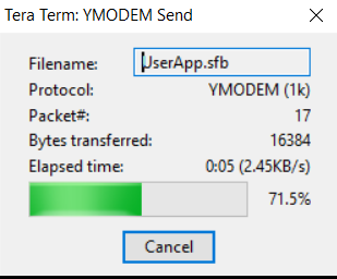

Also what do you see in the Ymodem window.
Here is what I see during the transfer:
Best regards
Jocelyn
