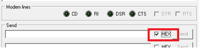

Try Hercule. I didn't test that feature but you can have a try:
To send with HEX format:

That's indeed what I have a doubt in.. I'm not using TeraTerm.

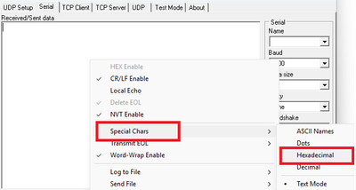

I've never been successful in getting TeraTerm to do raw binary/hex.
RealTerm does it: https://sourceforge.net/projects/realterm/
I'm sure there are plenty of others ...

2026-04-22 4:22 AM
It works with Hercules, but I can't get RealTerm to work. Thanks to both of you for your helpful support.
