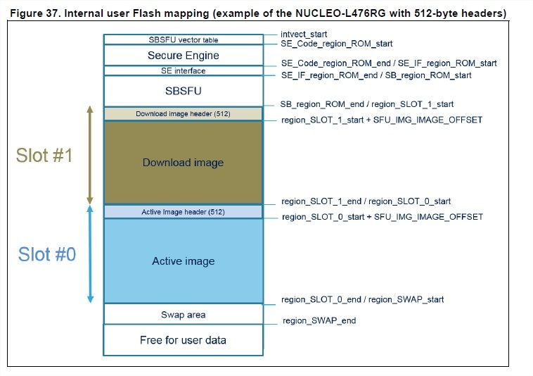

2021-01-27 10:04 AM
Hi Dominik,
About your sentence
" You are talking about this node like in the picture, right?
Like I understand, I need change this node everytime when I generate a new GCM key for a Bootloader/Application, right?"
I'm sorry I don't catch your question or the relation you make between GCM key and these adaptations.
What I said is that each time you generate a new firmware update, the nonce file should be changed. Basically recreated with a random.
Actually, if you delete the file, it is automatically rebuilt with random.
Regarding Free for user data, this is at it says: Free :). So, you can adapt your mapping to use it for your the swap and extent your slot size.
This area is in the example to show that you can use a part of the flash to write data that will not be erased by a firmware update.
This is usually to made to store device specific settings, tuning etc ...
Best regards
Jocelyn

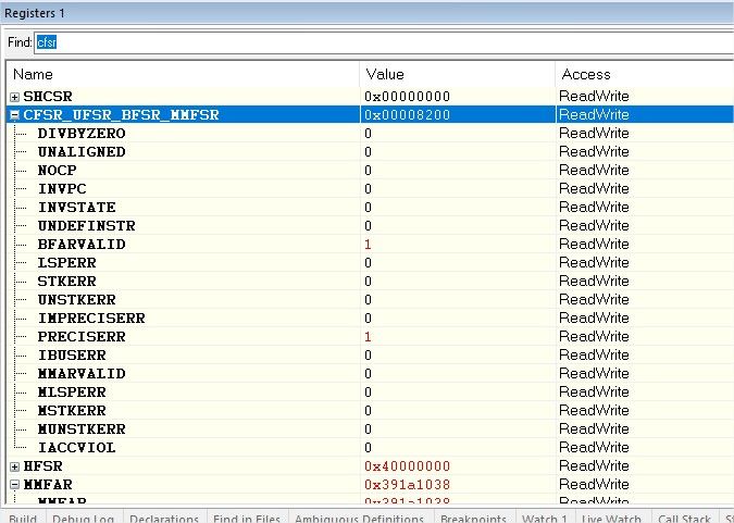

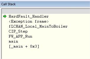

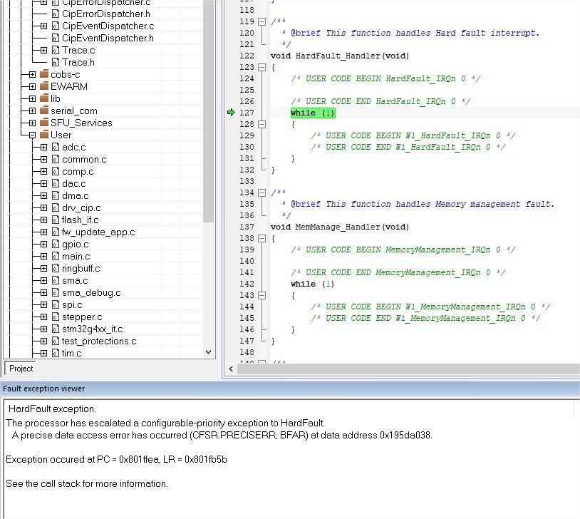

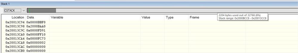

2021-02-02 1:07 AM
Hi Ricard
I found the bug. I changed the stack to 0x4000. But still receiving a hard fault.
define symbol __ICFEDIT_size_cstack__ = 0x4000;This is my HardFault.
I found out that I have a problem in the bfsr:
But now I know where is the root cause:
I have a UART running in parallel which is receiving a lot of communication. This I check in the mainloop with a ringbbuffer from @Tilen MAJERLE .
void CheckUsart1RXMessage (void)
static data_message_t rx_data;
if (ringbuff_get_full(&usart1_rx_dma_ringbuff) >= 1)
rx_data.data_length = ringbuff_get_full(&usart1_rx_dma_ringbuff);
-> This causes the ERROR! ringbuff_read(&usart1_rx_dma_ringbuff,&rx_data.data_a, rx_data.data_length);
//rx_message_f(&rx_data);
}When I disable the "ringbuff_read()", the HardFault is not happening anymore. If I enable the function, the ST is running until my statemachine gets running -> I gues a stack overflow or something like this.
