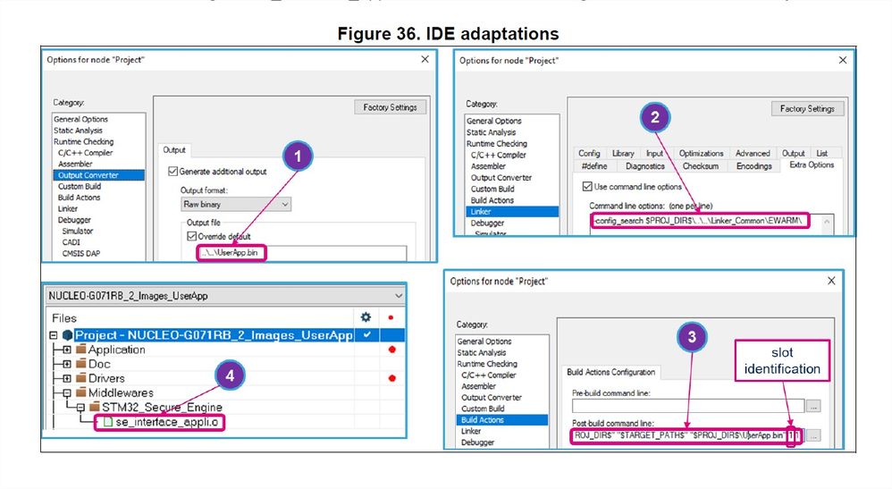

2021-01-27 6:00 AM
Hi @Jocelyn RICARD
Thanks for your answer, yes, all clear now thanks. You are talking about this node like in the picture, right?
Like I understand, I need change this node everytime when I generate a new GCM key for a Bootloader/Application, right?
