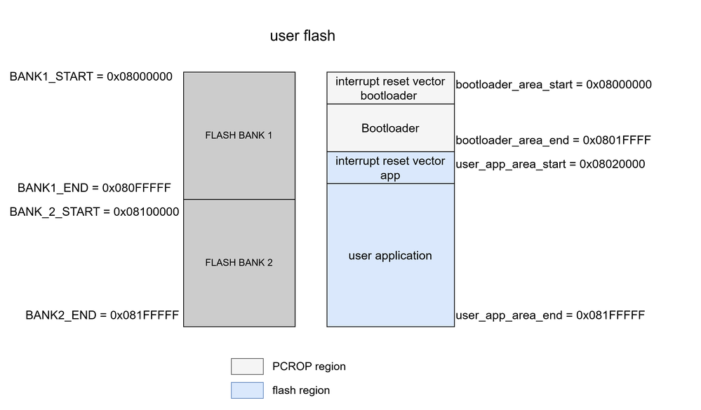

To create a bootloader that jumps to the application, you need to create two Cube projects:
  • 1 is the bootloader code, here you need to enable the PCROP region
  • 2 the user application code
Each project should have its own linker script file.
The Flash layout should be as follows:
  • Bootloader area: 0x08000000 to 0x0801FFFF ( make sure the boot code fits in that region)
  • User application area: 0x08020000 to 0x081FFFFF
Please confirm that you have followed this structure so I can continue the support.

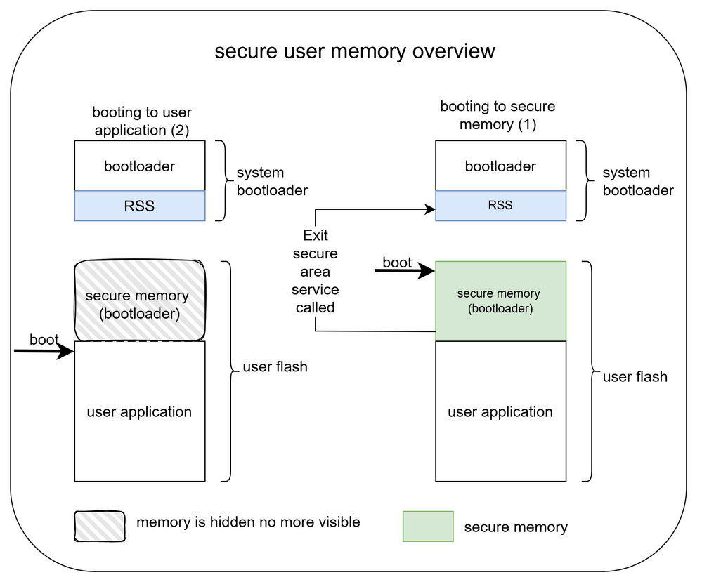

Hello @Domy_ST
I currently have a lot on my plate, and it will be a while before I get back to you.
However, this is a project generated by @Jocelyn RICARD from this community post.
I have not tested it, but it should work and be very useful to you:
  • Sets up a secure memory
  • Boots to the user application
  • Provides a firmware update over UART/YMODEM
The project is used on STM32H753 (not dual-core), but porting it should not be difficult.
Note on secure memory
The secure memory is a user flash region that gets executed at boot time, regardless of the boot mode configuration. Once executed, it cannot be accessed again (it becomes invisible) until the next boot.
The secure memory can be set using CubeProgrammer, or I suggest following the configuration used in the provided project: configured via RSS services, This is the recommended approach.
There are two main RSS services:
  • resetAndInitializeSecureAreas
    This service sets the Secure user area boundaries.
    • It can be used only when a secure area is being set for the first time.
    • A system reset is triggered after the service completes.
  • exitSecureArea
    This service is used to exit from secure user software and jump to the user main application.
Using secure memory with H755
Using HDP on H7 is a bit tricky:
  • In the provided code, it checks whether the security bit is set and whether the secure area is configured. If not, it sets them up.
  • Once you are in the secure area, you cannot connect to the board with ST-LINK until it jumps to the user application and also you cannot boot to the system bootloader.
  • If the code inside the secure memory is broken and cannot jump to the user application, you may not be able to recover the board.
Recommendations:
  • Test your code before enabling the secure memory area.
  • When exiting the secure memory, you can choose to keep JTAG either open or closed. For development, keep it open.
  • To remove the secure area, you can use RDP regression:
    • You can jump to the user application and then use CubeProgrammer to connect and perform the RDP regression.
    • The provided program includes an RDP regression routine. After launching the regression, you must wait around 10 seconds because a mass erase is triggered automatically.
    • If you interrupt this sequence with a reset, your board may become unusable because the code will be removed but the secure memory will remain.
If you want to keep the secure memory area and protect it against RDP regression in code, use:
aSecureAreas[0].removeDuringBankErase = 0;  // This will keep the secure memory
