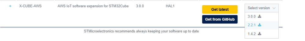

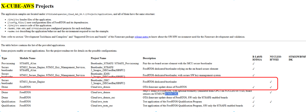

Hello @Domy_ST
Actually, there is an ST project that supports SBSFU on the NUCLEO-H755 with a demo application. However, it is somewhat old, and the last update was on 22-Dec-2021. You may need to port the changes yourself.
You can find it in the x-cube-aws version2.2.1: link
sorry for the confusion.
