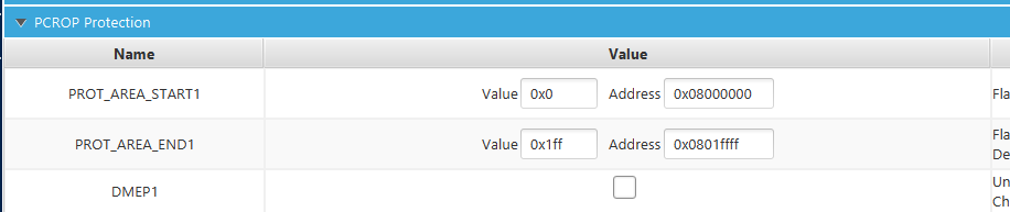

I'll try to explain how I set up PCROP below:
  • the PCROP address range
first I download the Bootloader SW (I modified the code so that inside the While there is only the printf of a string like "hi you are inside the bootloader with PCROP Active") and then I enable the PCROP in the range 0x08000000 - 0x0801ffff and DMEP = 0, so only the first sector of 128KB as in the image below
once PCROP is activated for that address region it no longer prints the aforementioned string.
