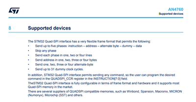

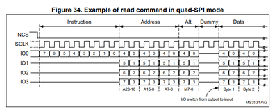

To check whether a device is supported by QUADSPI interfaces, it is recommended to refer to the device datasheet and to the RM0434 15 Quad-SPI interface (QUADSPI) section and check if the command format and order in the datasheet memory are in line with the QUADSPI frame format and order (Instruction, Address, Alternate, Dummy, Data).
Each command can include five phases: instruction, address, alternate byte, dummy, data. Any of these phases
can be configured to be skipped, but at least one of the instruction, address, alternate byte, or data phase must be present.
Also the AN4760 Application note section 8 Supported devices, can also help you check memory compatibility with the QUADSPI interface.

Thank you for your inputs now I have a clear picture, did digging through data sheet of the component i needed and the components mentioned in AN4760, other than the alternate byte phase everything looks fine. yes as @KDJEM.1 mentioned it can be configured to skip and it is mentioned in section 3.1.3 of the the AN4760.
