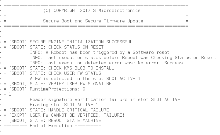

I am using the SBSFU with the KMS on my STM32L486RG. I activated the verbose debug in the config file and this is the output that i am getting when flashing the binary file combining the boot-loader and my user application at the same time :
As you can see the boot-loader fails to verify the the authenticity of the Firmware. How can I debug this problem?

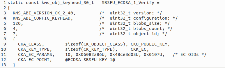

Thank you for the help everyone.
The issue was that because I use the KMS, the ECC public key is inserted in the kms_platf_objects_config.h file during prebuild.sh but for some reason even though i changed the private key in 2_Images\2_Images_SECoreBin\Binary. The public key was not updated during build.

2022-01-31 9:11 AM
Hey all,
I noticed that the problem is linked to me changing the ECC DSA private key. I generated a key using
python3 prepareimage.py keygen -k ECCKEY1.txt -t ecdsa-p256and placed ECCKEY1.txt in 2_Images_SECoreBin/Binary. If i change this key by the one provided in the example projects. The signature is verified correctly. Am i missing something ?
2022-01-31 3:09 PM
Validation presumably occurs with the PUBLIC KEY, if you change the private one, signing the image with it, expect to change the public one the authentication is using.

2022-02-01 2:37 AM
