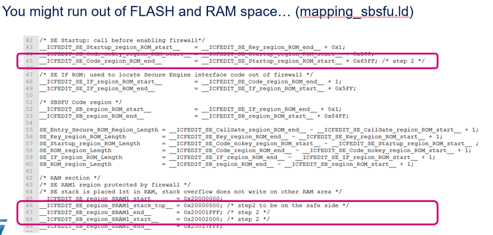

Then, you will have to tune the memory mapping probably:
0693W00000JO4XSQA1.pngThis can also impact the slots, you may have to resize them.
But, please, remember that when you add more code in the Secure Engine, you add more code in the secure enclave and this code can access your secrets.
