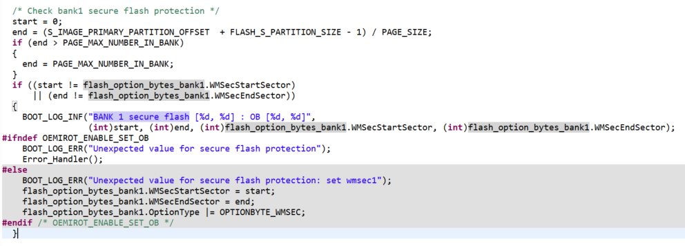

so, I find why occurred this error.
In the ob_flash_programming.bat file, sec1_end was set to 0x0E.
but In the code end value is set to 0x0F
end = (S_IMAGE_PRIMARY_PARTITION_OFFSET + FLASH_S_PARTITION_SIZE - 1) / PAGE_SIZE;
( end = 0x1E000 / 0x2000 = 0x0F )
what is correct?
what do i fix?

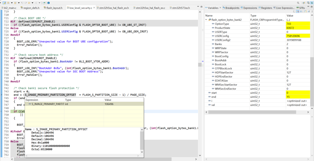

2024-01-07 10:11 PM
hello, Jocelyn
No, I didn't change configurations.
but I find diffrent points.
S_IMAGE_PRIMARY_PARTITION_OFFSET = 0x1a000
==> FLASH_AREA_BEGIN_OFFSET = 0x18000
FLASH_AREA_4_SIZE = 0x2000
and FLASH_S_PARTITION_SIZE = 0x6000.
is this issue causing from configuration?
2024-01-08 2:47 AM
Hello @Choppa,
if FLASH_AREA_4_SIZE = 0x2000, this means you have changed the configuration in flash_layout.h adding the secure data image setting MCUBOOT_S_DATA_IMAGE_NUMBER to 1 instead of 0.
Could you please, clean all your projects, rebuild everything, and then launch the provisioning.bat file provided in the ROT_Provisioning\OEMiROT.
I think it should solve your issue.
Best regards
Jocelyn

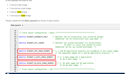

2024-01-09 3:21 AM
you mean. should I MCUBOOT_S_DATA_IMAGE_NUMBER set to 0?
but according to example MCUBOOT_S_DATA_IMAGE_NUMBER is set to 1
and I set the MCUBOOT_S_DATA_IMAGE_NUMBER to 0.

2024-02-23 8:09 AM
Hello @Choppa ,
thanks to a customer having same issue as yours I could figure out the source of your issue.
In fact, the information I was missing is that you changed the configuration.
I guess you set MCUBOOT_S_DATA_IMAGE_NUMBER = 1 or something equivalent.
Setting this changes the flash mapping.
To make your life easy, the new flash mapping is automatically computed and the scripts setting the options bytes configuration are updated.
The point is that, when using STM32CubeIDE, only .sh scripts are updated, not bat scripts that are used in case of IAR or Keil.
So, if you launch provisioning.sh instead of provisioning.bat it will work.
Launching the .sh scripts from windows requires that you have a bash available in your path
Best regards
Jocelyn
