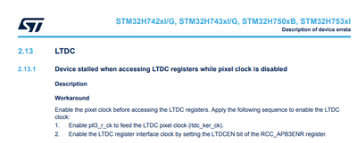

Hello @Franksterb92
There is a known limitation when accessing to the LTDC registers.
Please check if you have the same conditions as described in the STM32H753 Errata sheet

Hello @Franksterb92
