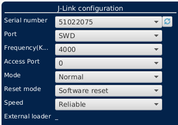

Connection:
Probe: J-Link V11.00 / SW version V7.98c
STM toolset: STM32 Cube Programmer / Trusted Package Creator v2.20.0

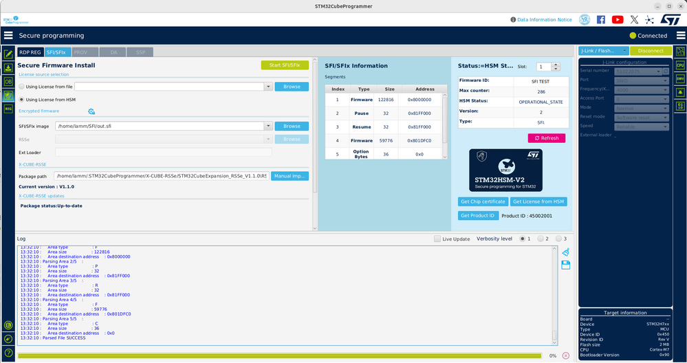

SFI programming fails with error:
Error: SECURITY State Fail
Error: Invalid state after SFI install !
Error: RSS internal system error or License is invalid !

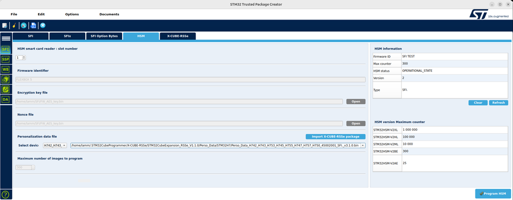

I also tried against the STM32H757I-EVAL board, which has a compatible CPU, with the same result.
HSM provisioning

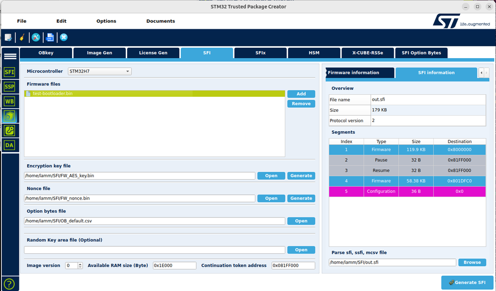

For Personalization Data I chose the group with the H753 in it, and from the 4 options in dropdown list the combination of "SFI" and Device ID "45002001" which is how the STM32H753 identifies.
For the simplified example, there is only one section of code starting from default address 0x08000000.
Settings for RAM size and continuation token are default, and seem to make sense.
Option bytes are, except for RDP level = 0xBB (level 1), identical to the defaults after mass erase.
SFI creation

Complete log:
15:25:42 : STM32CubeProgrammer API v2.20.0 | Linux-64Bits
15:25:57 : UR connection mode is defined with the HWrst reset mode
15:25:57 : UR connection mode is defined with the SWrst reset mode
15:26:05 : UR connection mode is defined with the HWrst reset mode
15:26:05 : UR connection mode is defined with the SWrst reset mode
15:26:05 : 51022075
15:26:05 : Device=Cortex-M7
15:26:05 : Device ID : 0x450
15:26:05 : Voltage : 3,30V
15:26:06 : UPLOADING OPTION BYTES DATA ...
15:26:06 : Bank : 0x00
15:26:06 : Address : 0x5200201c
15:26:06 : Size : 308 Bytes
15:26:06 : UPLOADING ...
15:26:06 : Size : 1024 Bytes
15:26:06 : Address : 0x8000000
15:26:06 : Read progress:
15:26:06 : Data read successfully
15:26:06 : Time elapsed during the read operation is: 00:00:00.004
15:26:24 : SFI parsing file started ...
15:26:24 : SFI header information :
15:26:24 : SFI protocol version : 2
15:26:24 : SFI total number of areas : 5
15:26:24 : SFI image version : 0
15:26:24 : SFI Areas information :
15:26:24 : Parsing Area 1/5 :
15:26:24 : Area type : F
15:26:24 : Area size : 122816
15:26:24 : Area destination address : 0x8000000
15:26:24 : Parsing Area 2/5 :
15:26:24 : Area type : P
15:26:24 : Area size : 32
15:26:24 : Area destination address : 0x81FF000
15:26:24 : Parsing Area 3/5 :
15:26:24 : Area type : R
15:26:24 : Parsing Area 4/5 :
15:26:24 : Area size : 59776
15:26:24 : Area destination address : 0x801DFC0
15:26:24 : Parsing Area 5/5 :
15:26:24 : Area type : C
15:26:24 : Area size : 36
15:26:24 : Area destination address : 0x0
15:26:24 : Parsed File SUCCESS
15:26:39 : getProductID command execution finished
15:26:42 : Requesting Chip Certificate from device ...
15:26:42 : Get Certificate done successfully
15:26:42 : requesting license for the current STM32 device
15:26:42 : Init Communication ...
15:26:42 : P11 lib initialization Success!
15:26:42 : Opening session with slot ID 1...
15:26:42 : Succeed to Open session with reader slot ID 1
15:26:43 : Succeed to generate license for the current STM32 device
15:26:43 : Closing session with reader slot ID 1...
15:26:43 : Session closed with reader slot ID 1
15:26:43 : Closing communication with HSM...
15:26:43 : Communication closed with HSM
15:26:43 : Succeed to get License for Firmware from HSM slot ID 1
15:26:43 : Starting Firmware Install operation...
15:26:43 : Activating security...
15:26:43 : Warning: Option Byte: SECURITY, value: 0x1, was not modified.
15:26:43 : Warning: Option Bytes are unchanged, Data won't be downloaded
15:26:43 : Time elapsed during option Bytes configuration: 00:00:00.002
15:26:43 : Activating security Success
15:26:43 : Setting write mode to SFI
15:26:43 : Warning: Option Byte: BCM7, value: 0x1, was not modified.
15:26:43 : Warning: Option Byte: ST_RAM_SIZE, value: 0x3, was not modified.
15:26:43 : Succeed to set write mode for SFI
15:26:43 : Starting SFI part 1
15:26:43 : Writing license to address 0x24020800
15:26:43 : Writing Img header to address 0x24021000
15:26:43 : Writing areas and areas wrapper...
15:26:43 : RSS process started...
15:26:53 : RSS command execution OK
15:26:53 : RSS complete Value = 0xCC000007
15:26:53 : Reconnecting...
15:26:54 : Device=Cortex-M7
15:26:54 : Device ID : 0x450
15:26:54 : Reconnected !
15:26:54 : Error: SECURITY State Fail
15:26:54 : Error: Invalid state after SFI install !
15:26:54 : Error: RSS internal system error or License is invalid !
15:26:54 : Aborting...

2025-11-11 7:18 AM
Hello @theHolgi ,
The Segger driver attached to STM32CubeProgrammer does not have the capability to handle SFI properly as far as I know.
You can use either STLink or Segger Programmer.
Best regards
Jocelyn

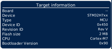

2025-11-13 1:07 AM - edited 2025-11-13 1:07 AM
Hello @Jocelyn RICARD ,
thanks for your answer, but I cannot confirm; I tried with STLink-v3 now and get almost the same log. The only difference in direct comparison is that the RSS complete Value changed from 0xCC000007 to 0x80.
(See log attached)
STM Programmer v2.19 also bears the exact same result.

Voltage : 3,30V
SWD freq : 8000 KHz
Connect mode: Normal
Reset mode : Software reset
Device ID : 0x450
Revision ID : Rev V
Device name : STM32H7xx
Flash size : 2 MBytes
Device type : MCU
Device CPU : Cortex-M7
BL Version : 0x90

AN4992 chapter 4.2.1 mentions a "Hash" with the comment "option must be enabled on all STM32 devices supporting SFI", and a screenshot of an obviously older version of TPC where this was selectable (in v2.20, the checkbox doesn't exist).
In the TPC CLI, it exists as an option to Continuation Token, but no matter if I set it to 0 or 1, my results are the same.
my SFI creation commandline:
STM32TrustedPackageCreator_CLI -sfi -devid 0x450 -rs 0x1E000 -ct 0x081FF000 0 -v 0 -k FW_AES_key.bin -n FW_nonce.bin -ob SFI_Default.csv -fir just_bootloader.bin 0x08000000 -o just_bootloader.sfi
Update:

$ ~/toolz/STM32CubeProg19/bin/STM32_Programmer_CLI -c port=SWD reset=SWrst -sfi sfi_cube9.sfi hsm=1 slot=1
STM32CubeProgrammer v2.19.0
Starting SFI part 1
RSS complete Value = 0x80
Reconnecting...
ST-LINK SN : 003300163232511639353236
ST-LINK FW : V3J15M7
Board : STLINK-V3MINIE
Voltage : 3,37V
Error: Unable to get core ID
Error: No STM32 target found! If your product embeds Debug Authentication, please perform a discovery using Debug Authentication
...retrying...
Voltage : 3,31V
...retrying...
Voltage : 3,35V
SWD freq : 8000 KHz
Device ID : 0x450
Revision ID : Rev V
Reconnected !
SECURITY State Success
Starting SFI part 2
all areas processed
Cheking security state after SFI...
Reconnecting...
Voltage : 3,36V
...retrying...
Voltage : 3,35V
...retrying...
Voltage : 3,32V
...retrying...
Voltage : 3,30V
...retrying...
Voltage : 3,37V
...retrying...
Voltage : 3,35V
Error: failed to reconnect after reset !
SFI Process Finished!
SFI file sfi_cube9.sfi Install Operation Success@Jocelyn RICARD
